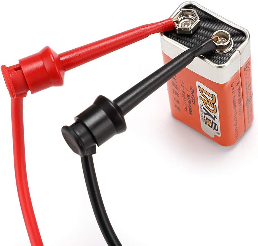

Make sure you have some mini-grabber leads for your multimeter, they are useful for voltage testing, and for measuring bias/idle current. You only need a 100W bulb for the A-700, even 80W will work fine. Make sure the bulb is wired in series, if you've built it correctly when you power up the amp through it, the bulb will grow bright momentarily then dim.
