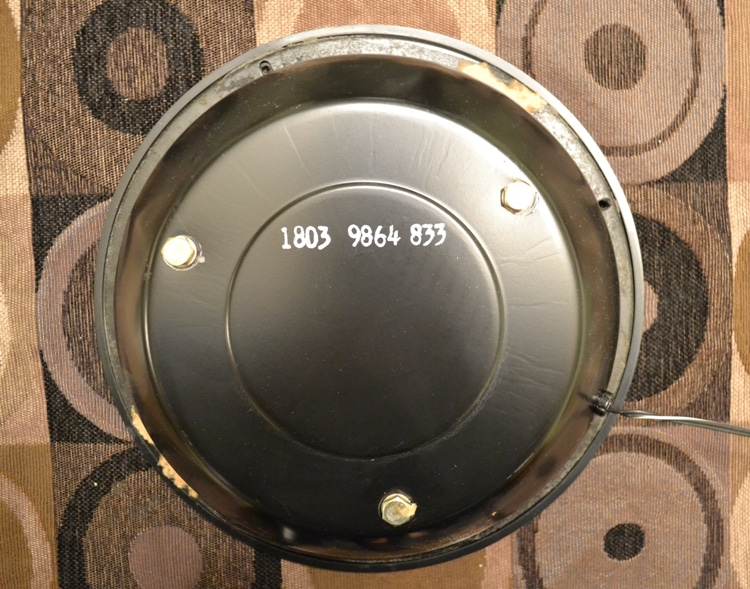

I'll also start taking things apart and will get the info and photos of the VMRs PeterSchut requested. While I have things apart, I'll also take a look at the crossovers. I don't remember much about them, other than that they were INCREDIBLY dusty after sitting unused in the previous owner's unfinished basement for over 20 years.
I'll probably order some replacement grill cloth, but it's too cold and damp to work with paints, finishes and adhesives this time of year. I don't have a dedicated workshop, so I have to do all my cabinet and finish work in the garage with the overhead door open. So, I'll probably have to wait until late Spring or early Summer to dive into the cabinet work. But, hopefully well before then, I will have some fully functional, if somewhat cosmetically challenged, Electro Voice Interface D speakers to listen to.
@PeterSchut - here's the photo of the back of one of the VMRs you requested. They both look the same and have the same part number.
I'll have to borrow a meter from the lab at work to measure the DC resistance.

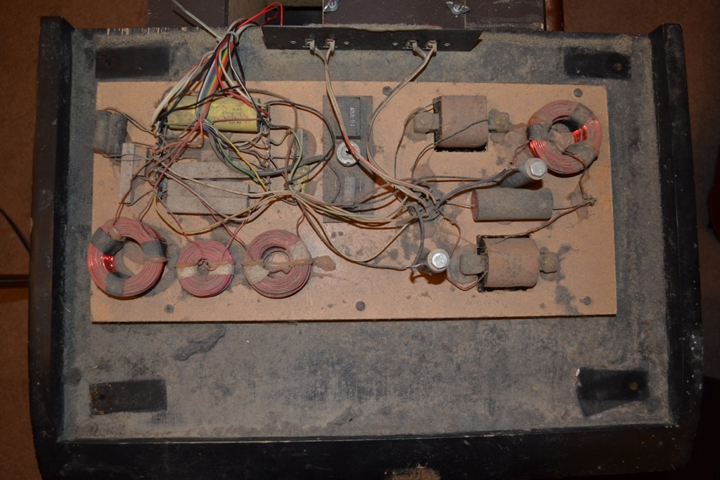

And, for future reference, he's a "before" photo of one of the crossovers:
Little bit dusty. There were also spiderwebs, a few dead bugs and some mice droppings inside both cabinets. The good news is none of the critters seemed to have chewed on anything. So, hopefully this is mostly going to be an exercise in cleaning everything up and repainting the bases.
I'll definitely replace the one electrolytic cap in each crossover. Any reason I should consider replacing the instructors or resistors. I may do the resistors, maybe spring for some fancy Mills resistors, but I'm always leery of replacing inductors for fear of altering the DCR of the circuit.
