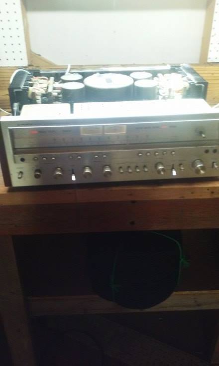

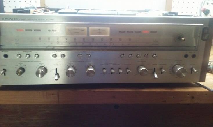

Hey I'm Joe, I live in Sw Florida and I've noticed from looking around and searching the forum that it does not appear that there are any shops to work on these Vintage receivers. This week my dad gave me his 1976 Pioneer SX1250... :cool::cool::cool: It has not been used in at least 20 years... This amp is the reason i love music, my dad used to play Dire Straits "Brothers in Arms" cd for me when i was little and "Money for Nothing" is the 1st song I ever remember hearing and it came out of this AMP, so it is very special to me. I got it hooked up at my house and It was brilliant for about 30 mins. I had the music on pause and heard a small "POP" about as loud as a muffled cap pistol. Now i have no audio output ANYWHERE, not A,B,C or head phones... I have found a shop in Naples that may be able to help me (Probably VERY Expensive because Naples is full of rich people) but I would also like to know where to start my own diagnosis, as I am reasonably competent with a meter and have the tools required. I build custom computers for a living and my dad worked for IBM for 40 years and has a degree in electronics so between us we have the skills i think to do it our selves. I don't want to pay an unknown (to me) shop if it is something simple... If it is major work best left to a PRO please say so as well...

One of the four boards in the back is where the pop probably emanated from. The two inboard ones can be removed and inspected by unplugging the Molex connections at the bottom of the boards and unscrewing the mounts. The inner right board is the stabilizer and is the power source for most of the receiver. The two outer boards are the amps and are not as easy to access but also can make pop noises. You may have to loosen the heatsinks from the chassis to access what you need to inspect.
Welcome to to the right place!
thanks for the replies guys.... forgot to mention the 1st thing i did was acquire the full service manual.... should have probably stated that... the scope is an old IBM branded scope Ill go to the shop in a bit and get more info on it... It is my dads but he left it for me to use... I'm hoping someone can help me figure that thing out as well... its older than I am lol so is the 1250... I'm going to read and re read Mark's reply a couple of times before proceeding... FYI the 1250 makes one of the most amazing guitar amps i've heard.... blows my Marshall stack out of the water.... we shall start on repairs tomorrow...
i can solder, haven't done much de-soldering, and I have never ran the scope... But with plenty of guidance I can manage... And I already stumbled across the parts list...
@markthefixer the scope is a 453... Ive finally got my bench ready and got my tools together and got her opened up... lets start from the begining... Step 1 lol... remove inner cards and loosen heatsink to get at outer cards, yes?.. then Step 2 carefully remove Stv-3h while not breaking the lead going into it... remove molex connectors and the two screws.... am i correct with all of this?
removed ALL 4 boards and documented Step by step and how many screws and where they came from. Put screws in corresponding labeled and numbered bags matching the parts they came from. I documented the direction and order of all Molex plugs and did not break the leads going to the heat sink Documented board numbers...... Everything looks squeaky clean apart from a bit of dust.. all fuses intact on 107 board on bottom of unit... what do i test 1st and what equipment do i need to use for said test and on what settings? All Molex pins are squeaky clean as well EXCEPT those connecting transistors in the heat sink, those look like they got pretty hot. everything else looks like the day it walked off the pioneer assembly line.. is it possible i just popped an output transistor or 2... to be honest there isn't even that much dust considering the unit has been stored for 20+ years... although i do live in a fairly humid area in SW Florida... the only other think that looks a bit odd is looking down on unit from top the left most board cover is discolored compared to the other two... I believe that is the tuner board correct?
