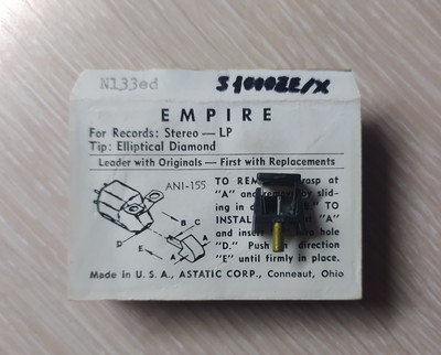

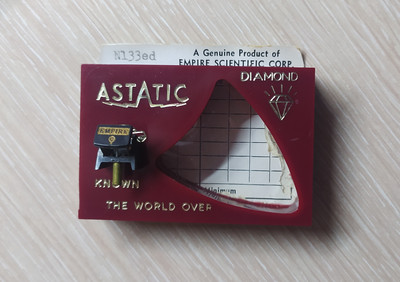

As for the 1000ZE/X, if the cantilever doesn't have a paint dot and the front of the flippy guard looks like the photo below, you're good.
Interesting! the stuck-on label (NMR133-ed and EM122-ed) points to an Astatic NMR generic and partially covers the "a genuine product of Empire Scientific", but the back label N133-ed indicates a made-in-USA genuine stylus, and the photo is so dark and badly angled that we can't see the flippy guard. To quote professor Han Solo, I've got a bad feeling about this.
There is no such sticker (NMR133-ed and EM122-ed) on my needle .
Exactly. There shouldn't be a sticker. I've never seen an "overlabel" on one of these packages, but it's a Brave New World out there now.
