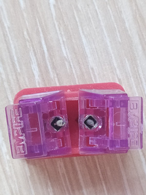

Indeed, however, the diamonds for E III (and certainly also for E II) post 85 have a cylindrical cantilever with a black dot, like today's diamonds. However, I confirm that when listening, I cannot distinguish between a pre 85 (conical cantilever) and a post 85 (cylindrical cantilever). It has nothing to do with today's reproductions, where there is still sibilance on certain music tracks. A NOS remains a NOS, and has nothing to do with a contemporary reproduction.
Great ;) The diamond you have is a contemporary piece, it is spherical, and produces a softer sound, or is less precise than a NOS diamond, but you should already have a good result with it. I also have one like that; it's not too bad while waiting to find a better diamond ;)
However, it was delivered with a higher stand than the original ones, it works too, but personally, I prefer it with a lower stand (it's a matter of personal preference).

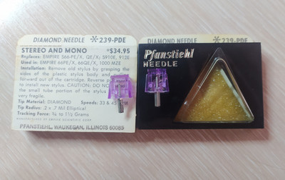

Has anyone dove into the differences in these suspensions? I'm looking for understanding after having two (believed to be original) 239-PDE styluses fail on me. I had one on the cart that pulled me into the world of empire carts. I bought a used replacement that sounded fantastic but also quickly failed.
The suspensions in the 239-PDEs I have are both colored green, while others I've looked at are black. I know the color of rubber products doesn't always mean anything, but it does indicate material type in automotive o-ring applications (oil vs. fuel vs. high pressure, etc). The green grommet material looks and feels like neoprene o-rings I use in auto AC systems. After having two fail, I have to wonder if this green suspension material is more prone to failure? Sample bias of 2.
I extracted one green suspension grommet to inspect and it is definitely much softer material than a black suspension grommet from a lower stylus in this line. The green grommetted stylus was playing well at first, then collapsed onto the record. Once removed, the green grommet seems to be in good condition, but the adhesive failed and allowed the cantilever to slide back to up into the stylus shank. I'm thinking the collapsed cantilever was due to failed adhesive, not old rubber. No wires I can see, although they are so small I could easily miss them.
It's a shame. The tapered stylus and needle seem to be in good condition, although I don't have magnification to confirm the diamond.
I just picked up a 237-DEM with a blank cantilever (no diamond, flat cantilever tip) and will probably pull the grommet of it out to compare too.
Oddly, both of my 239-PDEs have black blocks.
