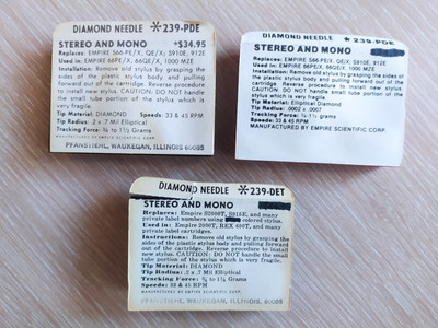

Can't sleep. I pulled it out and took a closer look. The back of the package actually says "Manufactured by Empire Scientific". The astatic 234-DE also has this text. I got them in a lot (different one than I talked to you about previously, wualta) along with these other odd balls that also have "manufactured by..." and are all in superb needle packages.2852.jpg2853.jpg
Also, good to know that the Superb packages can contain genuine styli.

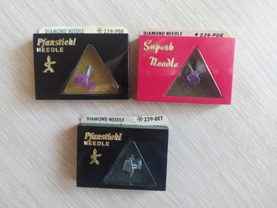

A strange discovery. I thought all Empire fans knew this. Especially professionals like Wualta. That the Pfanstiehl and Superb boxes are like twins. Only one is black and the other red.
