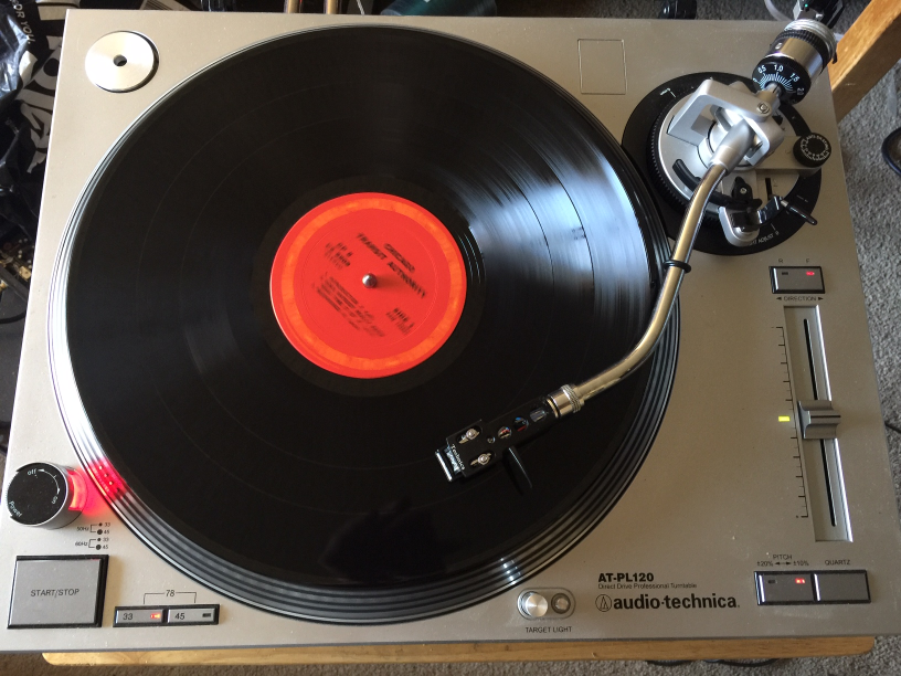

I was lucky - IMO - to stumble on this PL many yrs ago. Priced right too
Also it was enjoyable and fulfilling doing the Mods
Cannot see it in picture above but behind the counterweight , sticking up from TT , is my 78 cart. PL120 is a fine 78 spinner
