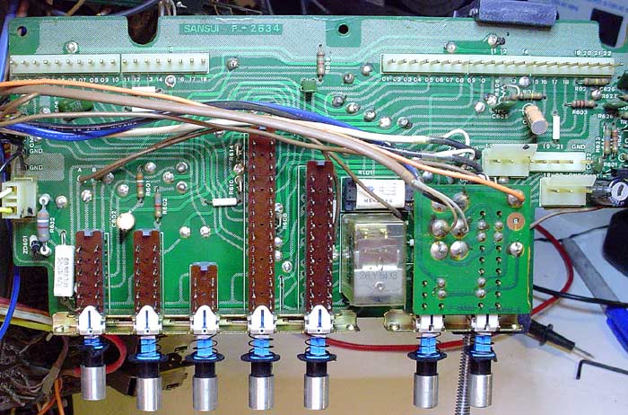

Not trying to scare you here. The 9001 was the flagship of the quad line, but if you haven't already heard, they're prone to failure on the board all those cute lil pushbuttons are attached to. It's double sided, and there's something like 50 pass thru joints joining circuits side to side that fail and go intermittent due to solder shrinkage and separation. That's why mine is in it's current discomboobalated state ... here's the board I'm talking about ready for the iron. One of the daughter boards has been removed showing the switches, and you can see the white lines that mirror the circuit traces on the OTHER side of the board. Every place you see an actual copper trace change to white paint, you'll see a blob of solder, and that's where it all goes wrong.
They go weird, missing a channel here and there, static, noise or somesuch ... and no amount of hoping, praying, or knocking it about will cure it. The pass thru joints need to be desoldered and cleaned, then bridged and resoldered with wire jumpers to get them back to working order.
Which by the way, is well worth it. Hard to beat a 9001 that's working right. And if yours is working right, consider yourself exceptionally lucky and go buy that winning superball lottery ticket. <G>
Once again ... not a derail ... but good to know. Save a lot of headscratching if and when things start to go south. The rest of the box tends to be fairly bulletproof.
