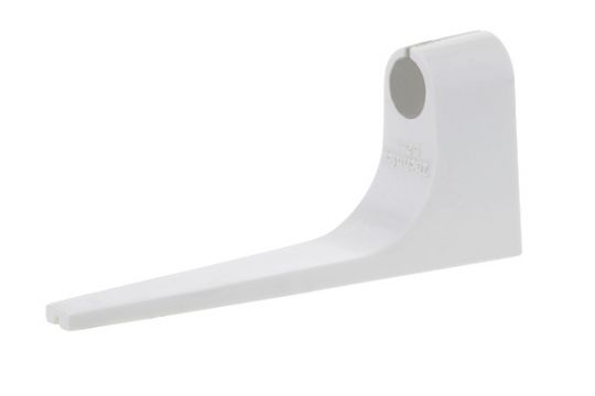

In retrospect, it is VERY UPSETTING to think more manufacturers do not provide similar setup jigs.
Although not the same quality, just about every manufacturer does supply alignment jigs. However, my own opinion is best to learn how to use some of the protractors (like the ones at vinylengine) and find out which alignment sounds best with that cartridge and turntable. My 2 cents.

Use of protractors was nearly a suggestion. My point was all good manufacturers supplied alignment jigs for setting overhang. I think the problem is most people have lost the jigs....except Miracords - they built it into the turntable.
UMy point was all good manufacturers supplied alignment jigs for setting overhang.
I curious, what other manufacturers have provided similar tools with their turntables?
Any current manufacturers do this?
I am honestly at a loss to find reference to similar tools being supplies with purchase.
My google game may be off.
From the BIC manual
All duals had them. Any tp4 type turntable doesn't use them because they don't need them. All early philips turntables had them. Many Japanese turntables had them. Miracord had an alignment spike built into the base, with a cleaning brush on top of it. All these were included with the table.Best source of information is in the Owner's manuals, it is hit or miss with the service manuals. The most recent table I have looked at is Denon DP-15F, which did come with an overhang gauge, but I don't have it.

The only one I have ever known of, FOR SURE, was BIC. It would make sense for others to include them.
I'm wondering how many manufacturers currently have them included with turntable.
