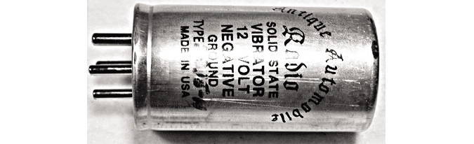

This part was broken when the radio arrived. I initially thought it was a solenoid of some type but the schematic has it labeled as a vibrator.
I have no idea what it does but would like to test it to see if it works at all.
An interesting link to the purpose and function of the radio vibrator.
