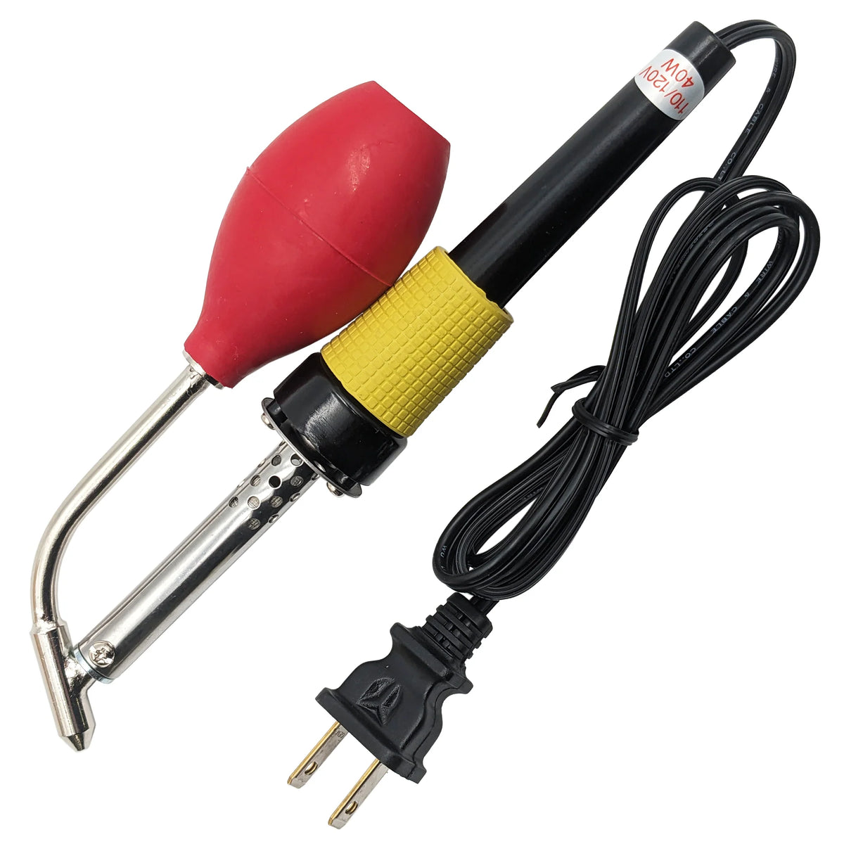

The heated one i have has an air bulb and you just blow it back out. The cold ones have plastic tips usually. Solder won't stick well at all and I tap it off/out.
