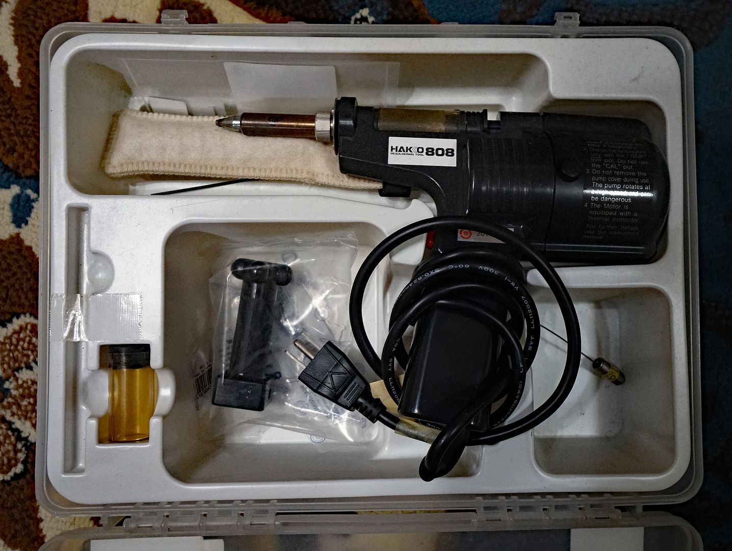

I have an old Hakko 808. Very reliable. You need to clean out the tip occasionally using the spring-like device at the bottom right.

I have a number of stations but all of them have a built-in vacuum station with gun. Adjustable heat for both the soldering tip and the suction gun. to remove solder just use the desoldering gun, heat the solder up till liquid, and pull the trigger, it will start sucking up any solder that is liquid.
This is my cheap on, I have another one at the house and it is a much better one, but more expensive as well. This one works just fine, but keep the tip poked out making sure no cold solder gets plugged up in there.
The best advice I ever took in, in relation to temperature controlled de-soldering stations, was de-solder horizontally* AND keep the suction on for 2 seconds after the joint is sucked off. Makes all the difference and it's rare (but not unheard of), that you need to remove/stab/drill-out the blocked solder blob in the iron core...
