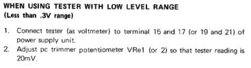

Anyone who can clarify this for me I will appreciate the help. In the service manual for the KA-6004, on a page between 5 and 7, it is titled "Audio Adjustment [BIAS ADJUSTMENT]. In this section it says to [connect the voltmeter to the emitter resistor of power transistors] (it does not specify the power transistors, but I take that to be Q1, Q2, Q3, and Q4. Nor does it specify the emitter resistors which I take to be Rk1, Rk2, Rk3, and Rk4). [Check voltmeter to point around 15 mV. If not, turn PC trimmer pot so meter has rating value.] This page has "www.hifiengine.com" in the lower right corner.
Then on page, after a page titled "Color Code", and with a copyright symbol, followed by "172-9 PRINTED IN JAPAN (T)" in the lower right, it says to, [when tester as ammeter, set pc trimmer pot (VRe1, 2) to minimum, Couple tester to collector of power transistor (Q3,4) and negative power supply lead. Adjust pc trimmer pot so that tester reading is 20mA.] AND, below that, it says, [when using tester with low level range, connect to terminal 15 and 17 (or 19 and 21) of power supply unit. Adjust pc trimmer pot VRe1 (or 2) so reading is 20mV]. It includes "THE SIMPLIFIED CIRCUIT": [Total resistance is R=Rk2 + Rk4 divided by 1 ohm] (Rk1, 2, 3, and 4 are .47 ohm, so adding two equals approximately 1 ohm) [Bias current (I) is 20mA. The voltage drop can be found from Ohm's law. V = I X R = 20 mV].
The [ and ] indicate where the wording is essentially directly from the manual and the ( and ) indicate what I have inserted.
I include screenshots.
Question is: Don't both of these adjust the Bias?
And, if so, which is the correct one?
AdjustmentOfAudioSection.pngAudioAdjustment_Bias.pngI am leaning toward the latter one using the terminals 15 and 17, and 19 and 21.
Thank you for the response. Do you think I need to worry about the 5mA difference between the Bias in Method 1 (15mV should equal 15mA) and Method 2 (20mV equals 20mA) causing an unwanted increase in the heat generated by these 52-year-old Power transistors?

Looking at Kenwood bias guide it shows 10mA. Let unit warm up first to get to operating temperature. Measure across both emitter resistors per side.
.47 +.47 x 10mA = ~10mV

I have gone back to using my cheap set of speakers until I feel more confidence in this amplifier not flaming out. As discussed previously, I was working on getting a good Bias reading on the power transistors. When I had attempted to set it per the service manual, I was not able to see a setting that was steady. Using the trouble shooting section of the manual, I concentrated on "Can't adjust bias current". After replacing VRe1 and VRe2 with some multi-turn pots, recommended in another posting, I got some better readings, but the bias voltage continued to fluctuate (it also helps when you set the meter to measure DC, not AC). I then turned to the "Bias voltage variation" section, and replaced De1, De2, and De12. After replacing those I am able to adjust the Bias (after letting the amp run for a few minutes to warm up) to a wanted voltage and have it stay at that point. After the much-appreciated discussion with eizner23, I initially set the voltage on the emitter resistors (Rk1 and Rk3 for Q1 and Q3, and Rk2 and Rk4 for Q2 and Q4) to 18.8. The service manual says V = I * R, where the emitter resistors are .47 ohm and the document eizner23 posted shows a 10mA bias current for the KA-6004. This gives .94 ohms times .01A for 9.4mV. However, I was hung-up on where the service manual showed 20mV and had a brain freeze. The next day I realized I had doubled the current and set out to set it to the 10mA. Connecting my trusty Radio Shack multi-meter, and powering on the unit I saw the left channel (the one I think I believe has been working correctly since I first powered it on) was now upwards of 30mV. Of course, this was after not seeing any reading on my meter, changing the VRe1 and 2 settings to see if anything changed on the meter, powering down, changing batteries, checking voltage on another device, then realizing I had the meter set to AC, not DC. I then set the Bias voltage to 9.4mV, which should give me the 10mA Bias current. I am attaching 3 screenshots which may help in visualizing what I am boring you with.

I did want to add that the section, "Audio Adjustment [BIAS ADJUSTMENT]", which says "connect the voltmeter to the emitter resistor of power transistors" is the same as the latter one which tells us to use "terminal 15 and 17 (or 19 and 21) of power supply unit". Connecting to pins 15 and 17, or 19 and 21, is connecting across the emitter resistors of the emitters of the two transistors. Looking at the inserted screenshot, you will see the emitter of Q2 goes to pin 15 through Rk2, up through Rk4 and to pin 17 to the emitter of Q4. The same for Q1 to pin 21, Rk1, Rk3 to pin 19 and then the emitter of Q3.
