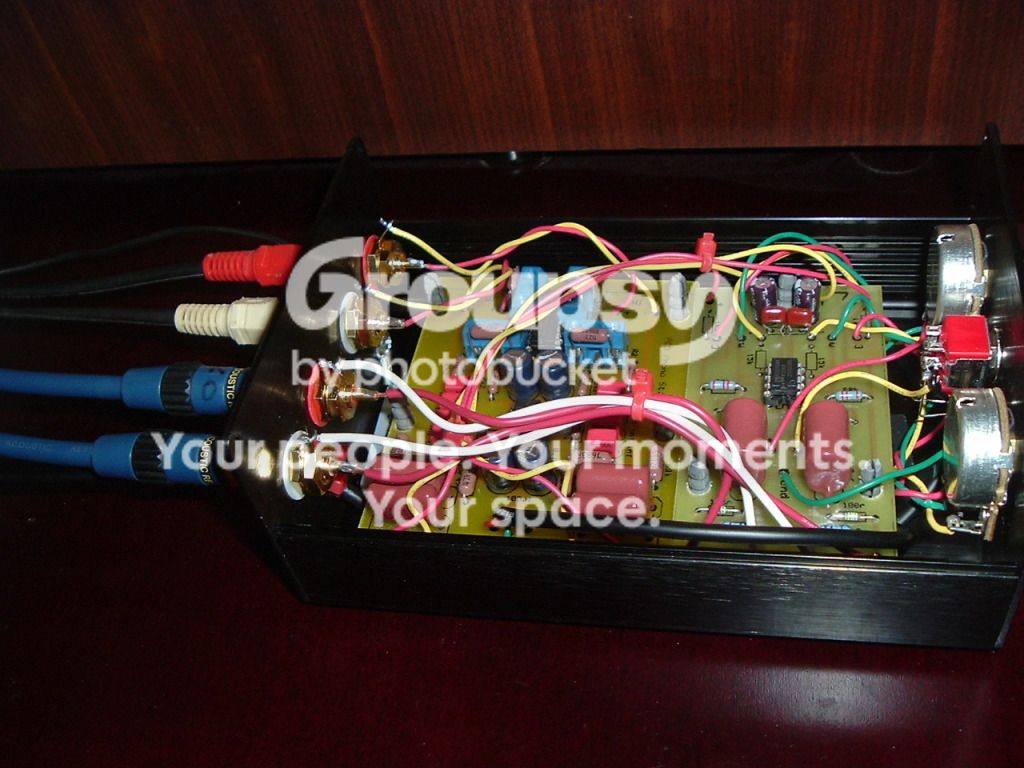

I got them from Digikey they are 10mm Terminal Blocks and found they are a bit big for my liking so I would suggest these, the legs are 7mm apart and the holes in the board need to be approx 50 mils or 1.25mm.
ED655/2DS Terminal Block 7mm
ED600/2DS Terminal Block 10mm

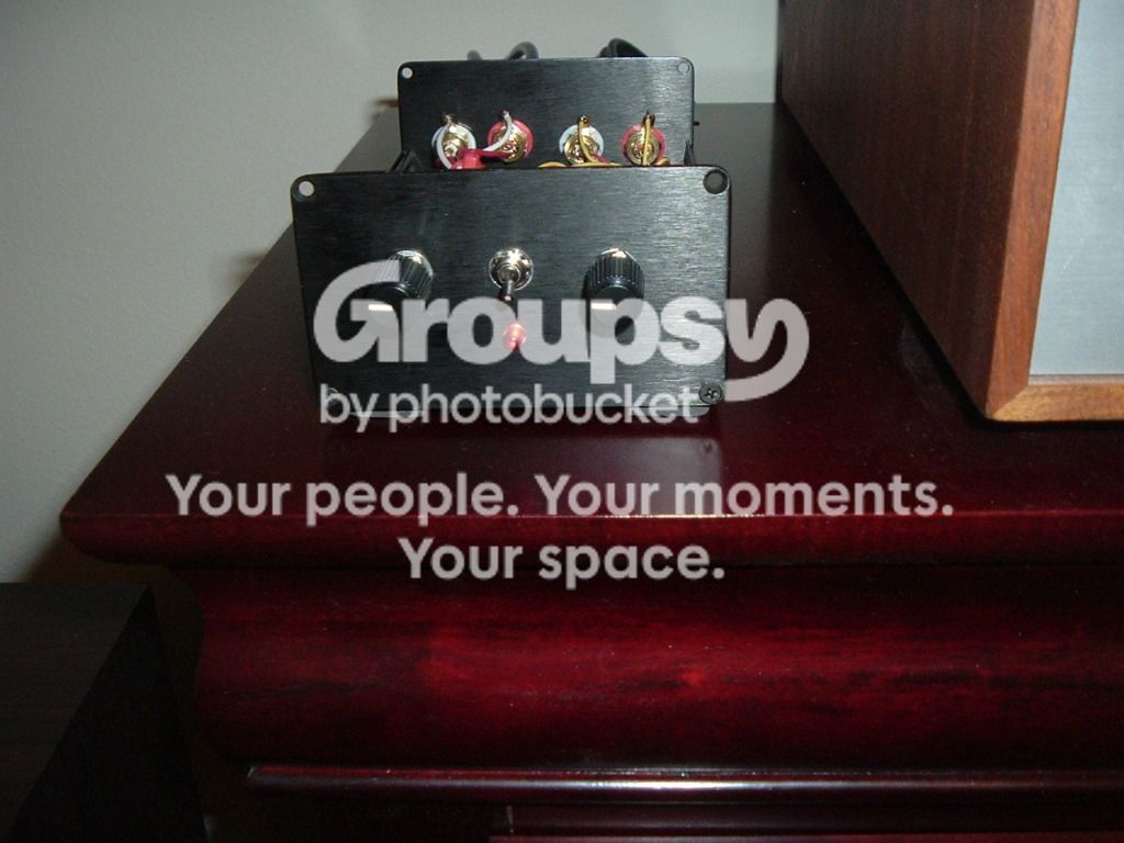

I finally got around to putting the dual op amp PC3 and the SSP (super simple preamp) in the same case (6"L x 4"W x 2.5"H). The good part is it's the only thing between the turntable and the power amp, no nasty tone control or other circuits to molest the sound. It draws around 15ma so it's easy on the batteries. And by using terminal blocks to mount the gain resistors I can swap them out to suit different carts without having to desolder anything.:thmbsp:
I am very pleased with the sound, I ended up using a pair of OPA2134's in the PC3 and an AD823 in the SSP.

What are the dial controls on the front of the box for?
Also, what recommendations does everyone have for standoffs, spacers, etc for mounting the PCBs to the chassis? I went with Hammond 1590 DBK from Digikey (http://www.hammondmfg.com/pdf/9c2pg42-43.pdf)
Scott
They are left and right volume pots, I have the dual op amp phonoclone and super simple preamp in the one box. So I only need this between the turntable and the power amp.

The main thing is I am putting these in for R1 & R2 so the resistors can be changed out quickly, no soldering, it will make it much easier when changing carts and adjusting the gain.
