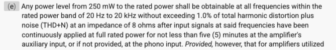

Correct on all counts. The FTC's current version of the "Amplifier Rule" (Federal Register :: Request Access) is still pretty strict. It has been weakened from the 1974 version, but part of that weakening was actually a reasonable reduction of not requiring all channels to be driven simultaneously for 5.1/7.1 AVRs. This was reasonable because rarely do all channels have max output in actual 5.1/7.1 content.
The current rule is still stringent enough -- it just doesn't seem to be enforced. For example, Yamaha's "100-watt" receiver (https://usa.yamaha.com/products/audio_visual/hifi_components/r-s202/specs.html#product-tabs) -- the specs are a joke (so is the performance of that receiver -- I had it very briefly). The higher level Yamaha 2-channel amps use valid specs and sound great -- but it seems like Yamaha isn't complying with the current amplifier rule for that receiver (so I think there is no actual enforcement -- Yamaha is not the only one).

Current Amplifier Rule Ecxcerpt Below -- still plenty strict even though less than 1974 (Federal Register :: Request Access)
