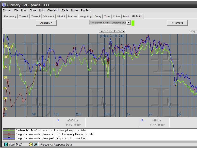

2. I am still concerned about the response between modal bass range and 1k. This has been a problem from the start. IMO, one of the biggest problems with home speaker DIY is measuring below 1k. That's where most of the fundamental notes in music are located, after all. Without reliable measurements, it is hard to separate the overall response trend under 1k from baffle step and bass issues, and then cabinet sound throws another wrench in the mix. All that said, I think the TD15 response is rising over its entire range, and countering that is tricky with a crossover point this high. Today, I'm going to see if I can find a place to measure lower frequencies without reflections in here. The AE measurement is not great, but it does appear to show a rise, much like I think I'm seeing and hearing:

Well, I finished moving the measurement setup, and it does seem I can get a little bit cleaner data now. It also seems that this nasty 400-500Hz thing is real :(. There's a very similar thing in the AE bench measurement above, but not the ground plane ones as much... Hmm... EDIT: no, that's just floor bounce at 400Hz, I'm a dummy.
