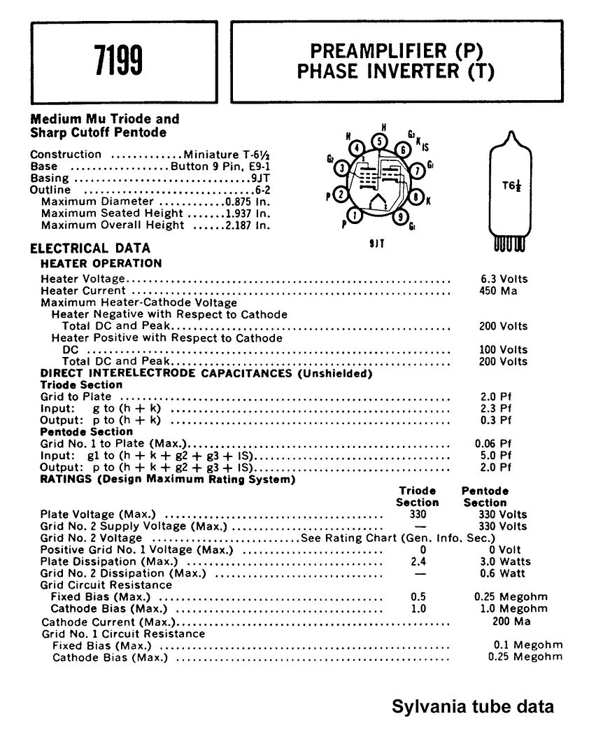

Now, how are the other voltages? On the 7199s or their substitutes?
Sylvania data sheet. :)
