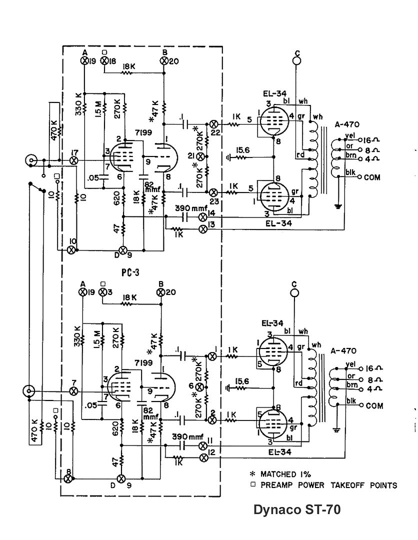

Now, to be sure.
V1 = GZ34
V2 and V3 = EL34 (push-pull pair on the top of the schematic?)
V6 and V7 = EL34 (push-pull pair on the bottom of the schematic?)
Any measurements of the 7199 tubes?

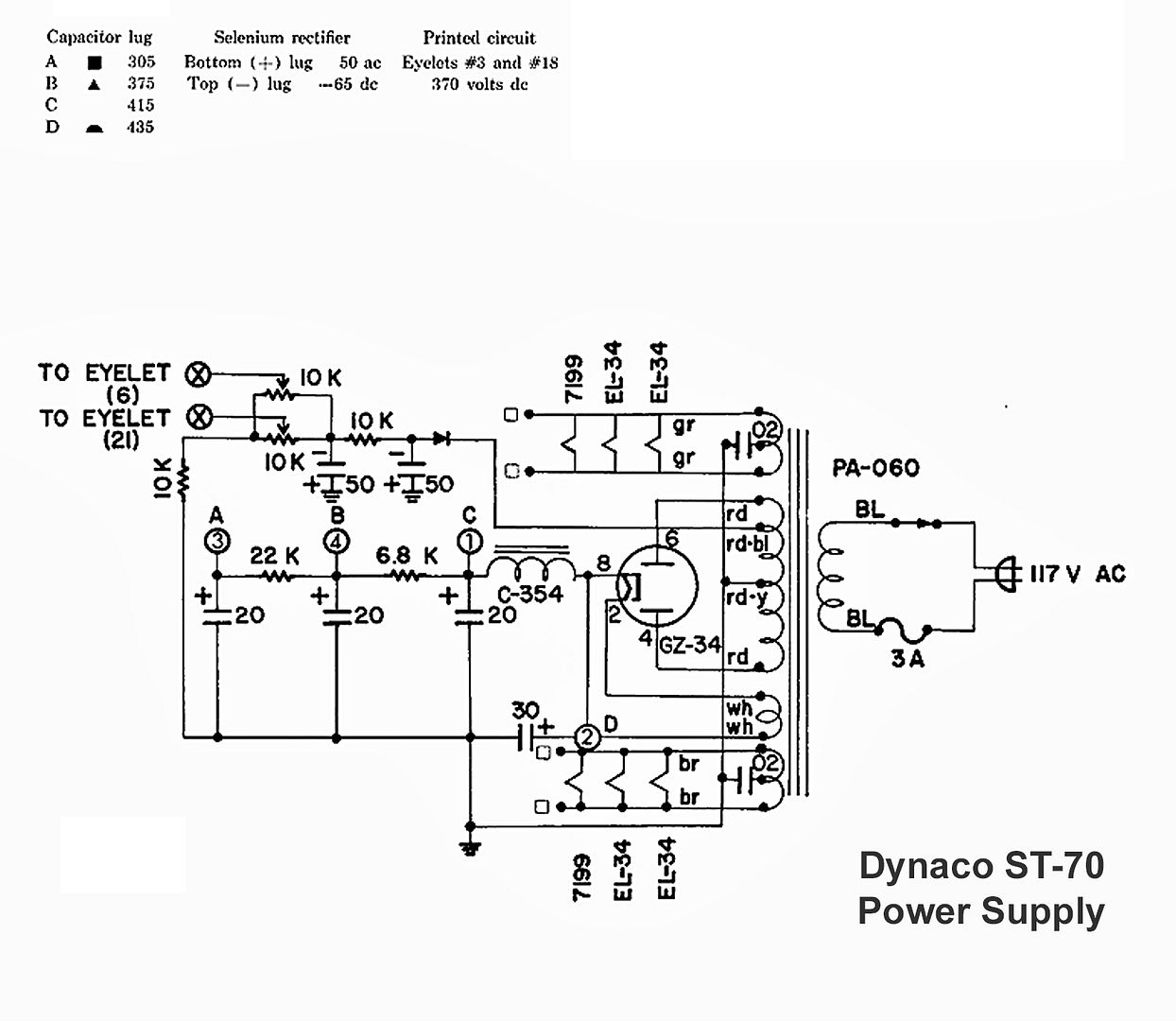

The B+ (after the choke) looks a bit high, but not seriously so. I’m not sure what new quad cap values you installed, I assume 525 V or higher. The manual says B+ should be 415 Vdc; try to get that. Be sure to use a 30 uF tap directly after the rectifier and before the choke. The one after the choke could be higher capacitance.
Something strange is going on with V2 and V6. I assume you have switched EL34 tubes already and the problem stays with the same sockets. Make sure the output transformer wires are correctly identified and used. Then carefully check the wiring and socket connections for V2 and V6 between the respective output transformer’s screen taps and pin 4. Do the same for the plate taps and pin 3. The voltage you measure on pin 4 are obviously too low.
The question is why. I also noticed the plate voltages on these two tubes are basically sitting at B+, close to the voltages you would expect for the screen UL taps. Are the screen and plate wire possibly switched on these tubes? But then, why are the “other connections” now used for screen, that much lower. Don’t know yet.
If all this checks out fine the next step will be to get some resistance measurements between the all taps on the primary side of the output transformers (measuring from the center tap) to make sure there is no problem there. Be care! Turn off the amp, unplug the amp and make sure the caps are all fully discharged before measuring resistances.

The quad cap, if the increased capacity replacement, should be wired so that the 40uF section is first in the string from the rectifier into the choke. Then the 80uF on the output end of the choke to the output transformer and dropping resistor to the 30 uF, then the second dropping resistor to the 20uF section. 40uf, then 80, then 30, then 20.

Here is a pic of the Quad Cap Installed. The next is my hand drawn schematic.
Hopefully it's clear enough. The half circle is 80uf. The square is 40uf. The triangle is 30uf and the blank is 20uf.
Your PS voltages look acceptable to me, at least at this point, if you have the 40uF after the rectifier, then the choke, then 80 uF, then 6.8k resistor to 30 uF and finally 22k to 20uf.
