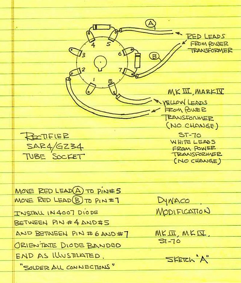

@spantou01 @Mr Boochie Hey guys. As long as I was ordering parts I went ahead and ordered some 1n4007 diodes to do the "Yellow Sheet" mod on the rectifier tube. Mouser delivered way quicker than anyone else so I installed them today.
I moved one red wire from pin 6 to pin 7 and soldered the diode between pin 7 and 6. Than did the same on pins 5 and 4.
Now when I measure the voltage I get 360vac on pins 7 and 5 where the wire connects. Measuring the voltage on pins 6 and 4 after the diode, I only get 9vac.
Remember, I'm a self proclaimed idiot that just happens to know how to solder. So, the question is...
Does this sound right? Is this the way it's suppose to work?
Thanks, Mark
Yellow sheet - Dynaco rectifier modification.
Do you have the diode's polarity like the diagram?
