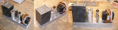

They are Hammond boxes; PN 1444-542 5" x 4" x 2. I had to special order them (thru CE Distribution). https://www.hammfg.com/electronics/small-case/chassis/1444
I then sorted out the layout, punched and drilled the chassis. Then I took the power transformer and output transformer end shells off and had them all powdercoated in a black wrinkletex finish.
I forgot to send the bottom covers along. I need to drill a hole pattern in them just to let a bit of air in. But I have all the parts rated well so there's not much in the way of heat generation inside the chassis.
I had to wire a good deal of the EF86 socket prior to installing it. I used the center pin (which not all 9-pin sockets have) as ground for the grids and cathode, so any hum or noise on the wire going to audio ground would be common mode and so not amplified (as much). To save room some of the terminal strips share mounting hardware with the tube sockets. I also used some of the transformer mounting hardware to also hold terminals in place.
The audio ground is floating via a 100 Ohm resistor at chassis ground potential. This required that there were no chassis ground connections used anywhere except that 100 Ohm resistor.
I mounted the Hammond 155 5H choke to one side of the chassis. There really wasn't enough room in the whole thing :)
I found a nice compact toggle switch for the AC power. It sits just below the power supply filter cap so had to be wired almost last. I wired the choke last, since it blocks so much access.

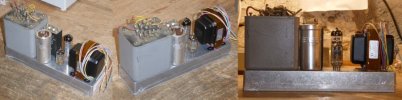

I screwed up on this one although its a bit neater as its the second channel. I meant to have the RCA connector where the fuse and power cord are so I had to run shielded wire to the input of the EF86, which I did not do in the other channel which simply uses a twisted pair.
The resistor connected to the red speaker connection is the feedback resistor. It still needs a compensation capacitor.

I just wanted to see where you placed the Hammond 155 choke, and how you organized the wiring all around. I understand why your box had to be thicker, in order to house the non-visible choke.
An alternative for me could be that die-cast box :
A bit larger with 145x121mm instead of your 127x101mm folded chassis, but 35mm thick instead of 52mm, assuming I could place the choke outside... I'll have to trace it with my parts to check...
