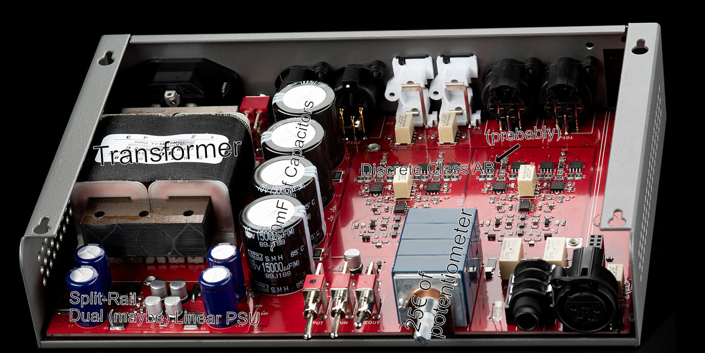

I have a Dac SMSL SU8 version II and I want to make the mods caps for better ones, I'll try for pictures here for appreciation, I accept suggestion.

My amp Schiit linear psu caps Panasonic M 1000uF 35v :(
Modding Nichicon FG 1000uF 35v?

Looking at their data sheets, M series Panasonics are general purpose caps with no notable special features other than small size. Pretty much any audio grade cap of the same value should work if it will fit. But if it is in the power supply, I would use Nichicon UPW series caps.

The Panasonic Caps I thought of putting in their place the Nichicon FGs of equal value to the Pana, for the sake of space, but there are the smaller aluminum ones among them, in this one I have doubts about which others to change, not if I leave they will end up invalidating the exchange of Pana M.
Nippon chemi 15000uF 16v black caps I don't intend to mess with, but this Pana M I think it's good to change, anything else that friends can suggest?

I found the Elna Silmic II 100uf 35v for the 4 SMD and Nichicon FG 1000uf 35v for the 4 Panasonic M.
any suggestion?
You could replace the 2 Nichicon FG's with these:
https://www.mouser.com/ProductDetail/Nichicon/LKG1J102MESYCK?qs=4lWw5qRttGL2FqLd0O%2BGFg==
What are the original cap diameter, and is there any height restrictions?
I'm 42mm tall, but a little bit wide, I could lay them down.
I put beside the photo of the previous model the Jot 1 that had 6 caps Pana M 1000uf 35v, in this new model Jot 2 only comes 4 Pana M.
Anyway I need to take out the pans and in place for better ones, the amp has a lot to gain by removing these pans that are not good for audio, so I was looking at the smaller FGs and mixing with Silmic II also smaller.
But I take any good suggestions.
What is the size of the original caps, the Nickicon KG's come in other diameters.
Other choices are Nichicon KS and KW/FG if you want a radial.
What is the exact cap diameter, height, and value?
