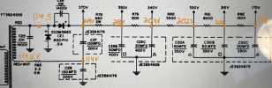

These are the results. I wasn’t getting the 300+ volts on the other side of this resistor, and although it should be 630, it measured 14 Mohms. I removed it from the circuit this morning and there is no continuity across the resistor, and resistance is high. Giving that there was no voltage on either side, this must be the issue right?
I think the power supplies are okay as I found all other voltages as expected

yeah that should be the screen supply. No screen voltage means no current flow and no output. It explains all of the symptoms, but not the cause. Make sure there isn't a short somewhere at that node and that the cap isn't in backwards. Resistors don't just burn up for no reason.
So, I replaced the 680 Ohm resistor that was shorted with new power resistors. I also checked all of these resistances which all check out okay, give or take.
However, V1,V2,V3,V4 all still do not light up, and the amp has no sound out of it. Back to checking voltages again.
All my new caps were taken out of the circuit, and tested that none were hurt. They all have the capacitance in spec. I then rewired things back up just to double triple check according to the schematics and still these are the voltage readings.
My only hint is should the diode section be taking the 114.5V and stepping it up to 370V?
Any help sourcing some new diodes / caps (C25,C26) if you all think that is the issue?

Don't give up, this shouldn't involve any difficult troubleshooting. The doubler appears to be working, although all the voltages are too low. I think you need to measure the AC voltage across the output of the transformer. I would remove the load first by temporarily disconnecting one lead of both rectifiers. I believe you should measure140V - 150V AC.

Going from my severely aged memory, that at times can dredge out a decent piece of information, IIRC, some of the input tubes are receiving their heater voltage from the cathodes of the 7355 tubes. Nicht vas? If those tube are not in place or if the circuit is not complete then you will not have those 3 12ax7 tubes working.

Is C25 a 10k pico-farad 1400VDC disc cap? That would equal 0.01 mfd/1400VDC.
C26 seems to be part of a cap can (JE 3584176). :idea:
Also, V1, V2, and V3 heaters are in series. If anyone of the tube's heaters fail, they all will not light.
I'm betting you installed C29 backwards, it shorted, and burned out something in the cathode circuits of the 7355s. V1,V2, and V3's filaments are powered by the cathode current that the 7355s draw.
None of the above suggestions (although otherwise reasonable) will pull the doubler output down a whopping 140V. Measuring +229V at the top of the doubler indicates a major failure somewhere. The doubler is functioning, because the middle connection between the caps measures +114V. I think this must either be the transformer or the 3.3Ω surge resistor.

There are only six passive components in the voltage doubler circuit. It’s got to be one of those components or the power transformer secondary winding. It shouldn’t be terribly difficult to track down.
As mentioned, eliminate the power transformer first by measuring the AC voltage across the secondary leads. Unloaded it should measure around 150V AC.
That being said I have seen cases where the secondary measures fine unloaded, but when under expected load, it measures much less voltage. That could be your situation here but I kinda doubt it.
If the transformer measures out fine under no load, move on to test the diodes. You can temporarily lift one leg of the ceramic caps straddling each diode. Don’t forget to test those ceramic caps as well. The ceramic caps are not strictly necessary, they keep the switching noise down but you can test the power supply without them.
Don’t make any assumptions. Test everything, but test one single thing at a time. Take notes if it helps you diagnose and keep things straight.
