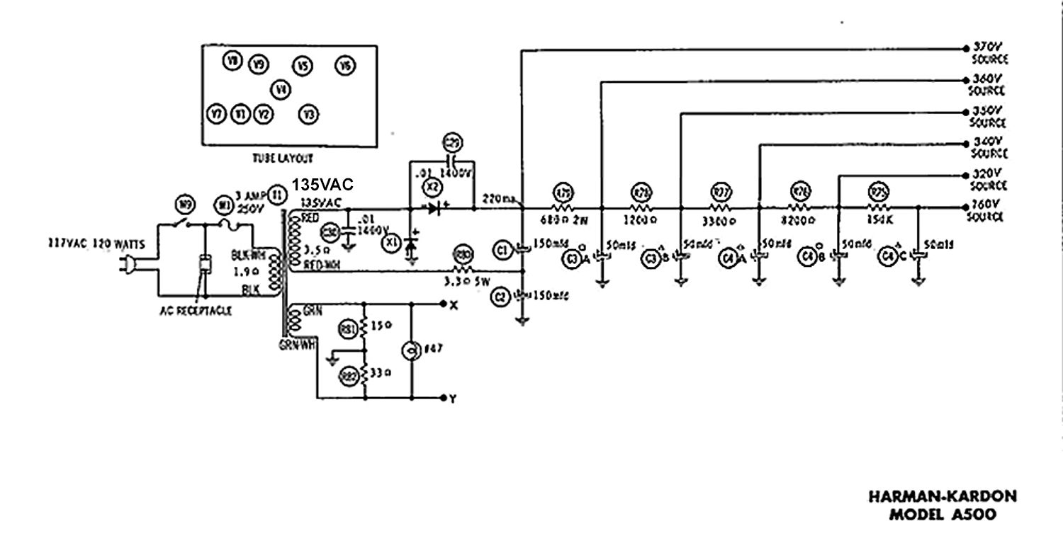

Okay so did some testing tonight.
1) The plates of the 4 output transistor are not glowing. Just the heater elements as it appears it should.
2) I used my tube tester to check for tube quality, opens and shorts and all 12AX7s passed (the ones that have zero glow to them).
3) I then cut the two wires for each side of the secondary windings for the transformer. These are the results.
Here we can see the schematic. I cut both wires for the secondary windows. I then measured each one for AC voltage aagainst the chassis ground.
Does this mean that my transformer is bad? If so, what’s next? I have zero idea how to source a new one.
Anywho, here is my wiring as well. Please let me know if you have any suggestions to move forward. Thanks!
Using chassis ground, you're just measuring the leakage inside the transformer. This is irrelevant at this phase of troubleshooting, and the measurement number does not indicate anything amiss in that regard.
Do I understand correctly that you measured 154.6 VAC across the transformer secondary? That's about right. To have that no-load voltage available, yet only derive about 230 VDC from the doubler, indicates A) a high resistance somewhere in the supply, B) dried out (or wrong value) doubler caps, or C) an extremely heavy load (which should blow the fuse if it's the correct value). I guess the next step is to reconnect the transformer and measure doubler output voltage without a load.

So your measured voltage across red and red/white is 114.5 VAC?
I found this schematic with the nominal secondary VAC listed. Your unit's 114.5VAC is 85% of what HK lists as nominal. Do you have a 120VAC source (the Variac is up to the full house voltage)?
What is the VAC across the green and green/white heater lines (X and Y)? It should be around 6.3 VAC (all tubes pulled). If the voltage is low too, maybe you have a tired power transformer. If the heater VAC reads 6.3VAC (+/- 5%), the problem lies in the secondary HV windings.
As stated above measure AC voltage directly across the secondary. Place one meter probe on one side of the secondary and the other meter probe on the other side of the secondary. Sounds like you did that? And you measured 154 VAC? (that would be about right, in an unloaded situation).
Do you have any big wattage handling resistors? Anywhere from 1K to 5K--just something put put a load on that secondary winding for a few seconds? I expect the secondary will deliver the current under load, but while you've got the secondary wires disconnected, might as well take a measurement with some load on the secondary. By "big wattage" resistors I mean something in the 50W territory.
