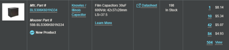

evaluating physical size vs mounting options for the new 30uf 600v film caps. should only need three of these monsters for the b+ board circuit. c-r-c up front after the v-doubler, darl in the middle and r-c-r in the back including b1 separation. simple circuit as it should be.
