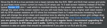

i wonder if bumping up the g2 resistor is a quick and easy way to limit the max usable output of a tube amp. to protect the out-txf from an over-powered design.
*text search (ctrl+f) for fender 470 for quick location of the paragraph, its a long page of text.
yes but its a bad one. You'd be better off reducing the screen voltage but keeping it a stable supply rather than letting it shift around so much. That will allow for more consistent performance across the usable power range. With a mushy supply the distortion performance tends to get a fair bit worse as power output increases. Lower screen voltage reduces how much current the tube can swing so less power output. Makes for a happier match into a fairly high Z transformer too.
