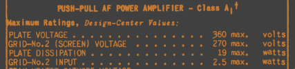

revisiting the 6L6g data sheet, noticed a few more things of design concern (amp circuit).

grid-2 voltage max regardless of amp class
interesting to note with fixed bias, negative grid supply, the are ratings for zero signal and max signal. which gives the motor room to rev higher vs idle. that explains a few things in regards to output wattage reserve before distortion kicks in (tube magic).

screen g2 resistors are 220r 2w even though that was short lived and updated to 4.7k which may get bumped up to 47k to create 70v drop. after revisiting the 6L6g data need to be mindful of the 270v max rating and 19w limit for the anode/plate.

perhaps a closer look at what the screen grid (g2) should be doing and how much current/milli-amp activity should be expected.

47K as a screen resistor supply would be a bad idea. that would be the place to use a regulator to drop things if you want one in here. Depends on the particulars what the shift in current would be but anywhere from 50-300% depending on operating mode and loading would be typical. Its enough under any arrangement that high value resistive droppers work very poorly, even with the shunt load of the front end tubes added in to reduce the swing from min to max.
doing calculations for rg2 based on zero and max from the table above would be:
47k at 3.5-11ma = 164.5-517v drop
33k = 115.5-363v drop
definitely a moving target although a 1k value would be 3.5v-11v variance and the currently installed (no test drive yet) 4.7k with the above parameters would be 16.45v-51.7v which seems suitable to some extent. having g2 react with signal level including out-txf inductance vs hard limited to a b2+ supply might be an interesting sonic/output comparison. should be easy to monitor rg2 voltage drop with a signal generator source to see how much the system reacts, in terms of g2 milli-amp swing.
*page 3, interesting data
screen dropping by a factor of 3 is really bad for performance. The current flow through the tube is significantly impacted by that voltage changing. Some amps did have the screen drop that much, but those can be significantly improved by tightening up the supply. Even the old texts will talk about regulating the screen supply with shunt regulation or use of gas regulator tubes. Better amps and commercial gear did it that way, but lots of consumer stuff did not.
