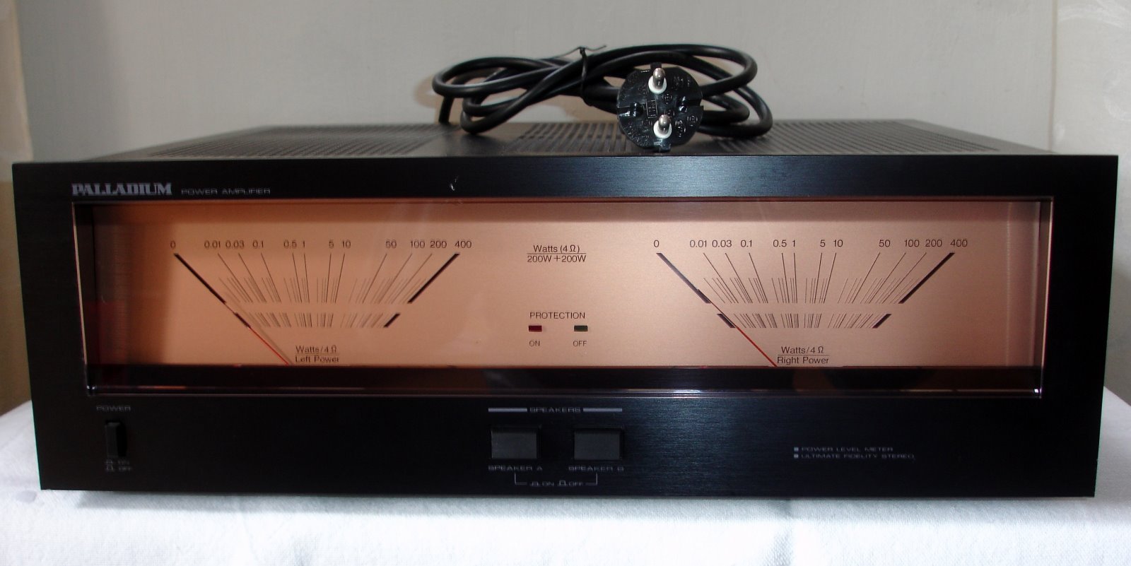

I allways desired big VU meters. Finaly I got ones. (Not Macintosh but I like them).
It is well known Lotte LA 1200 Amplifier sold as Uher, Palladium, Hantor and many other names. Inside is STK 4048 based amplifier. Right now my is on total refresh.
Color of VU face is beautifull and movement (in dark) is mesmerizing.
