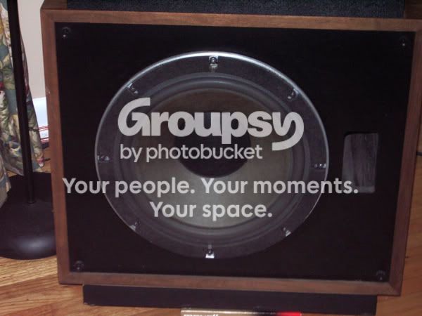

Help identify this 12" speaker!!!!!
This OCS Speaker Repair shows an Altec model 14 woofer and it really doesn't look at all like the OP's woofer.
http://www.speakerrepair.com/mm5/me...de=genem&Product_Code=OCSRP263&Category_Code=

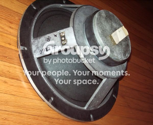

Somehow, I'm getting a Japanese woofer vibe, the OP's woofer has some JBL frame copy to it for some reason, can't remember who has a cast frame like this though. The tab off the flat part with two holes reminds me of JBL's push terminal mounting.

Will somebody post a pic of the correct Altec model 14 woofers and then we'd have this done?

Is everybody getting them mixed up with the model 15 woofers?

Your first clue is push on terminals, found on the 14 woofer, the 15 has the same red/black button spring terminals as most Altecs through the 70's used.
Also note in your post #25 the clear EIA and date code. 391 is Altec, date code is 13th week of 1981, spot on for a model 14/9842 monitor.

Now, for the ESS woofer. I've been holding the baggage on this one. But, that frame looks EXACTLY like the woofer frames from my AMT towers, EXCEPT, my woofer frames were stamped steel. However, the shape of the basket down to very small details is extremely similar.
