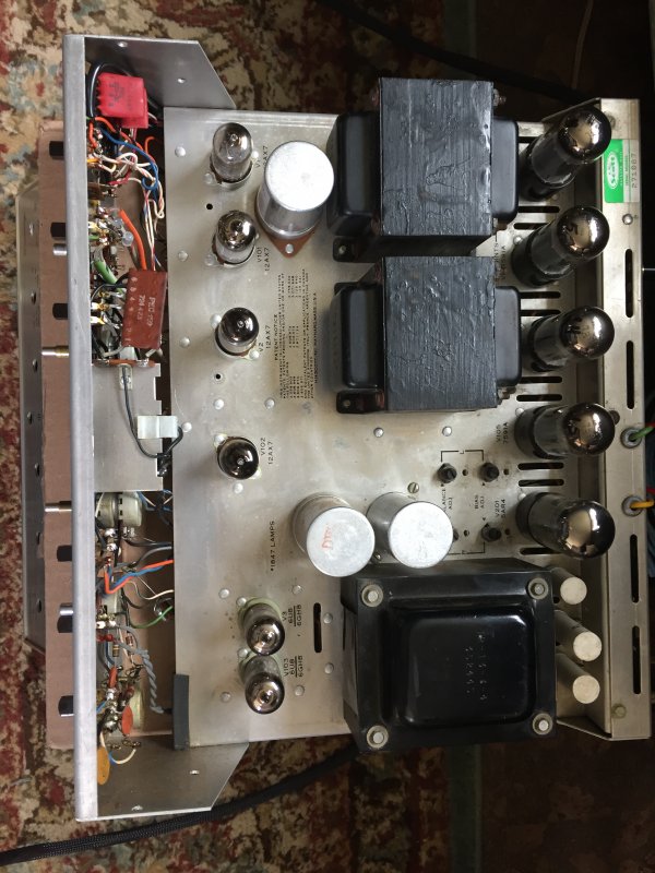

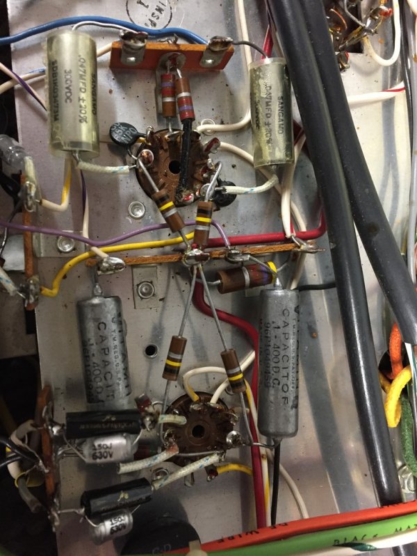

I just took possession of a very nice Scott 233, completely original as far as I could tell.
I ran it up on a variac to 117vac , did a few voltage checks and set the bias and balance.
Sounded pretty good a bit muddy and blurry and hum. I played it awhile anyway to get a good feel for it.

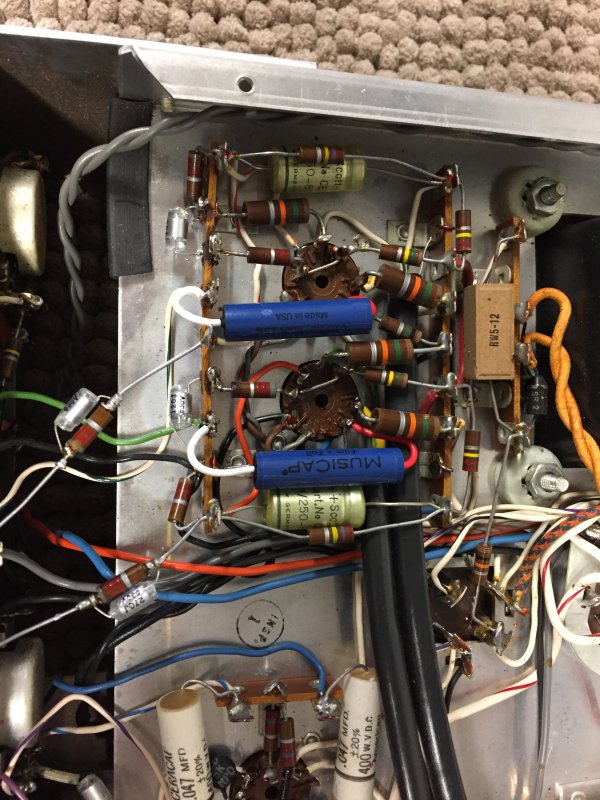

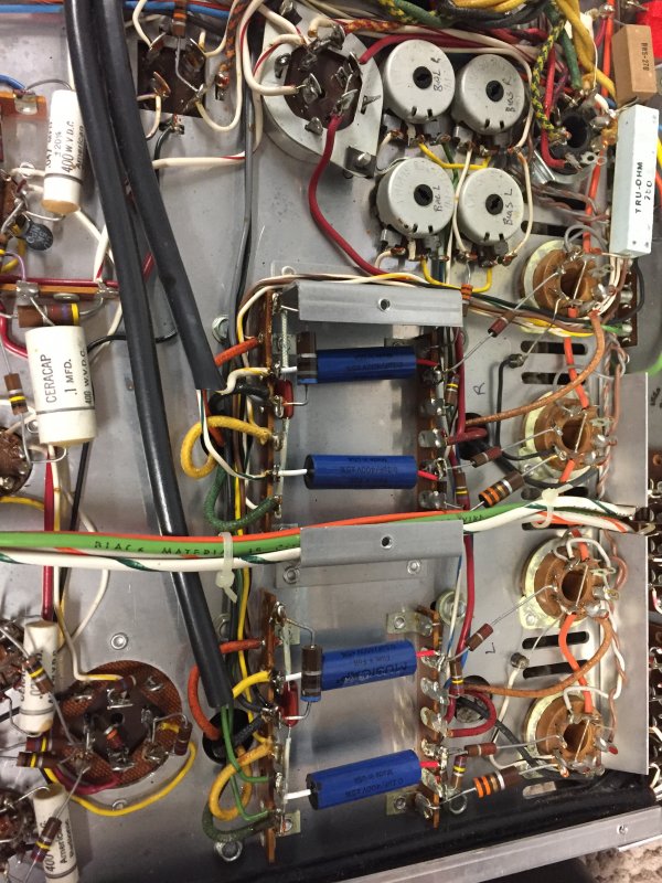

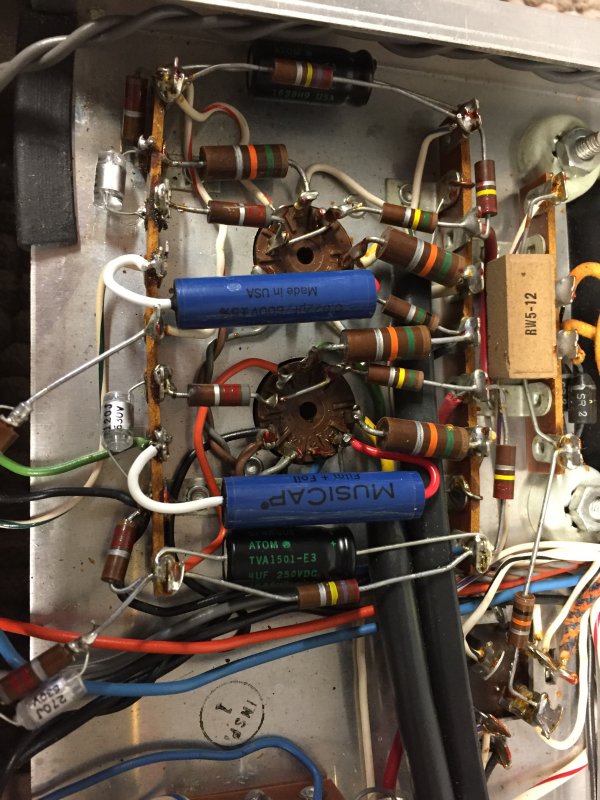

Next I proceeded to order new can caps from Antique Radio Supply and a few Musicap coupling caps.
After I installed the Electrolytics and the coupling caps to the output tubes. I reset the bias. And Played it again. Much improved and the hum was minimal. I had the preamp cover off and it was better with it on of course. Next I decided to replace a few of the pf value ceramics and some more coupling caps with parts from JustRadios. I used polystyrene for the PF values, much nicer again. More Air and depth. So off we go. I then installed some PIO caps to the line stage and some more Musicaps to the Phase invertor driver. I also replaced the very difficult to get to .047uf caps on the phono output. I use PIO again.
WOW, huge improvement but not at first . At first there was distortion and I thought I had screwed up. But I could hear it getting better by the second so I left it and hoped it was the old caps forming or settling in. It appears it was something breaking in, because it was sounding much better, more depth and air, reverb, details I had missed earlier in the music.
I still have to rebuild the Phono stage. I think I will replace the PEC phono eq with some discreet parts ie. polystyrene and quality resistors. Then the phono coupling caps. I did try the phono stage but it was rather lackluster compared to the line input. I also built a bucking transformer that drops 12vac. It measures around 108-9 vac. Seems Low but the internal voltages now read very close to the schematic. Sounds really good.
The hardest part is getting to the .047 input caps. I let the front panel down by removing the screws on the sides and bending it froward and down. That helps alots.

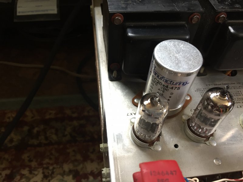

Did you get your hum sorted out? Some scott amps have a special can capacitor which is built with the can as common positive which performs double duty as a filament supply for the front end and as a bias supply for the power tubes. If those caps have failed they may be the source of a significant hum. Somewhere there is a thread on how to rebuild them. I'll bet it sounds fantastic. I know all of my Scott amps do.
Yes, The Hum is pretty well sorted out. I knew about the reverse polarity Bias/Filament Can. I have not replaced it yet. If i do, I will restuff it with 100uf 100v caps though. I did replace the other two Cans with new ones from CE Distribution.
I measured every Cap and Can I took out. The Main Filter Cap Can was oozing black tar but measured OK on my Heathkit IT28.

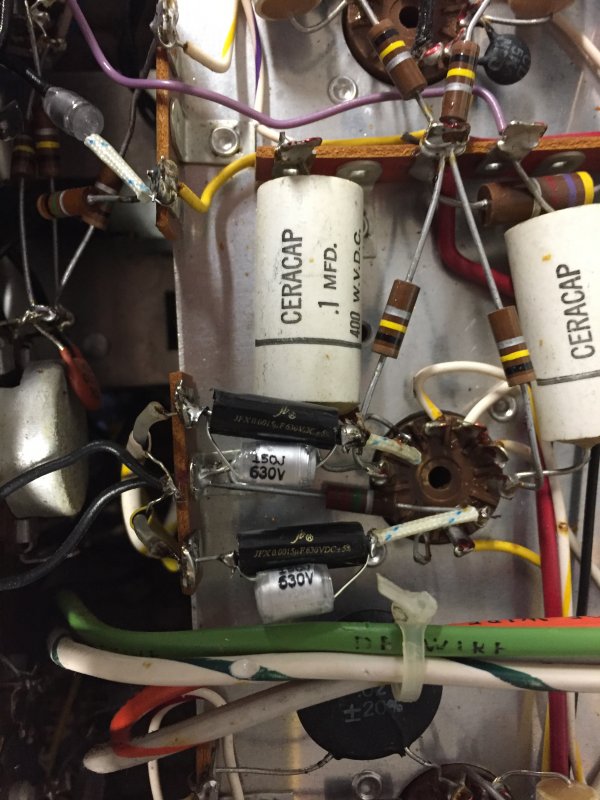

All the other caps measured within tolerance except one .1uf Ceracap to the 7591 grids .
Looks great! This is one I'd love to hear!
Ill post some more pics when I get it back together, After I rebuild the Phono section. I am very impressed with the PIO caps and the polystyrenes.
I replaced the ceramic pf caps after I listened to it after the Musicaps, and they really took the grainy-ness out and sweetened the presentation.
The oil caps were last and they made a big improvement as well. I purposely mixed the oil caps with the polypropylene Film n foil caps so as to not have too much of a good thing.
Bypassing the cheap .0015 film caps with the polystyrenes made a nice improvement that was audible. I listened before and after.

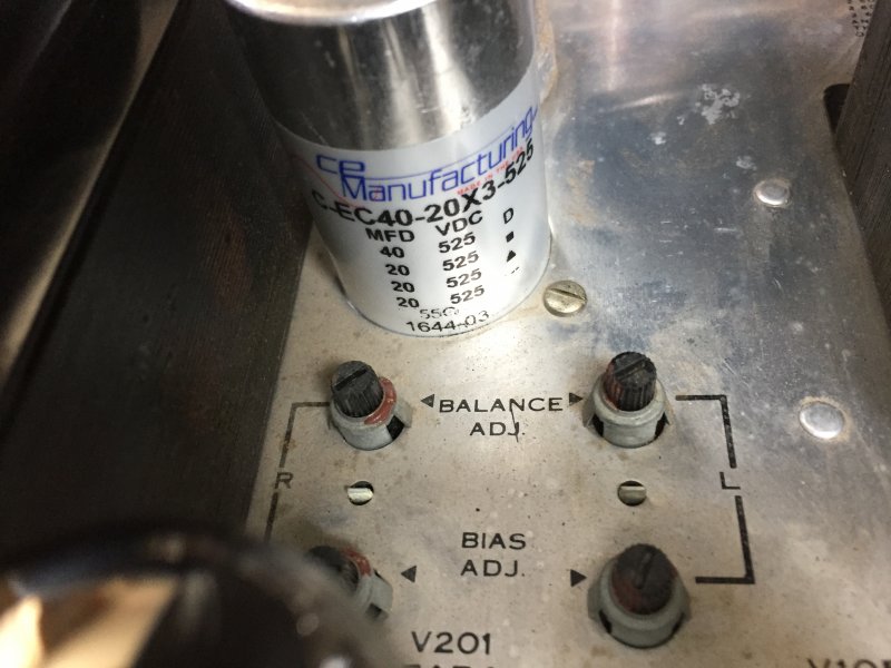

Billy, I too agree.......'Great Job'!! Like Don, I also share a love of Scott amps. I'm just curious about your process for setting/adjusting the bias? In reading through your work thus far, I didn't notice if you had installed any current sensing resistors on a 'by tube' basis or if you're just going off what's there? IIRC, Scott had some kind of like 3.3 ohm resistor or something like that in the cathode side on some amps...... but I've found that eliminating that and simply installing 4 individual 10 ohm resistors off each of the cathodes on the 4 output tubes makes the process of bias/balance MUCH easier!! Honestly, that bias/balance setup that Scott has in these amps is one of the more favorable IMHO. BUT......you need to have the individual test points associate with it. Those aren't too hard to install, and places like Antique Electronics Supply sell what they call 'Tip Jacks' that make perfect test points.

I used the Scott stock 3.3 ohm resistor. I measured them and they were pretty close. Like 3.43 , 3.37. I balanced it by measuring plate to plate voltage.
I may install 1 ohm Dale resistors one day. Right now Im trying to fry bigger fish, like detail, depth, wide range response. I made a huge improvement by disconnecting the PEC 299 filter and reducing the gain with a 27k resistor( i paralleled across the 1meg grid load.) Then increasing the coupling cap feeding the line stage to a .47uf. . I tried unbypassed cathode with 2.7k and it was very clear but ultimately went with the stock bypass cathode for better low end. I might should have gone lower , like 22k or less. I dont have a scope or distortion analyzer, so it's all by ear and some experience.

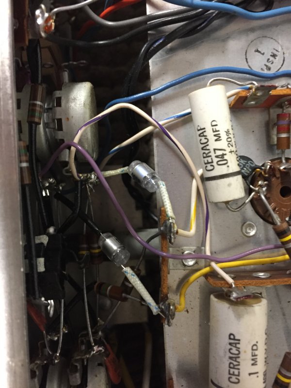

Whats the best Capacitor ? NO capacitor! I just figured out I could remove the .0015 coupling cap to the line stage. I had a .47uf in there yesterday.
It is the best yet. I was getting some weird faint distortion on the leading edge of the signal. When I removed the cap it went away. Sounds full and clear.
edit.. When I say removed it, I mean I replaced it with a jumper wire.
I may even remove the .047uf from the phono stage. I measured it and there is 5mv there, not sure that is a problem, might cause some popping when switching.

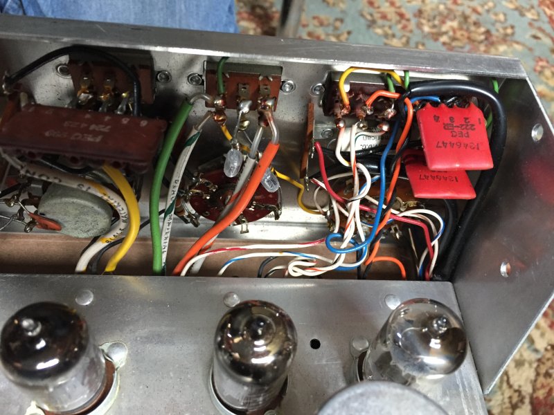

Here is a pic of the current line stage, without the coupling cap. The Best sounding yet.
The White and Yellow wires replaced the cap. Also, see the Polystyrenes I used for the Tone controls.

Today I replaced the .047uf coupling cap from the phono stage going to the line stage with a wire. Sounds much better. Much improved low end definition and body. Fuller , firmer sounding, yet more clarity. I measured 5mv dc, no popping when switching . I think this is part culprit in the weak bass performance of the stock phono stage. I have NOS Sprague HYREL Q caps ,0.1uf coming for the phono stage as well.
I imagine HH SCOTT was trying to trim the low end due to expected placement in a stereo cabinet with built in speakers. And the quality of the average turntable in those days. I am using a modified Lenco L75, no problem with rumble.

I am using the stock Scott 3.3 ohm resistor to bias and measuring the dc from plate to plate of each pair 7591's to set balance. I do have some DALE precision 1 ohm resistors I could replace the cathode ground and use to set bias and balance. I could also use the transformer shunt method to measure ma of each tube as well. But I am pretty comfortable with the 3.3 ohm setup. I did measure them and they are pretty close to 3.3ohms. My amp has a test point on the top of the chassis( factory) to use the 3.3 ohm.
