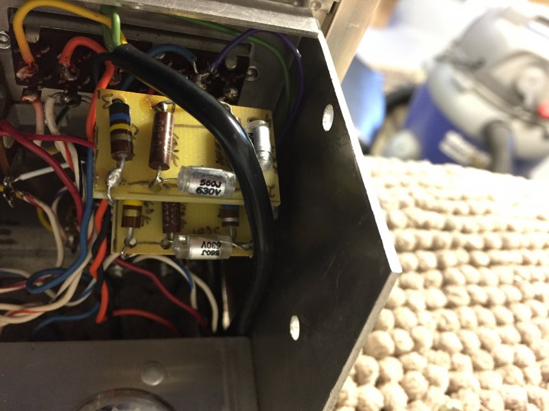

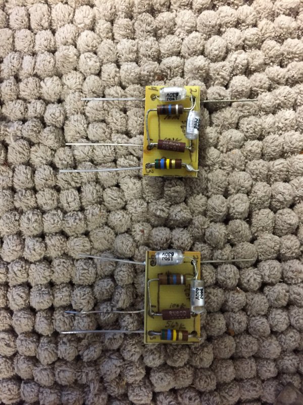

I rebuilt the Phono EQ PEC chips with discrete parts . Used Polystyrene caps. It really sounds much sweeter and more detailed, It is now on par with the Line stage.

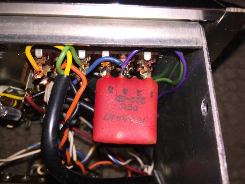

I can tell you 100% the 222er is the Riaa equalization of the phono stage. you dont want to bypass it if you are using the phono for vinyl playback. You can bypass the 299 PEC in the line stage, but you will have too much gain and need to reduce it, via voltage divider etc. certainly do one at a time and listen. I left all of the carbon comp resistors and the noise level is perfectly acceptable. I did recently replace the 3.3 ohm bias measuring resistor as it would drift with the heat too much. I installed 4 individual precision 1 ohm Metal Film resistors, most people use 10 ohm as they are easier to measure by digital VOM.
I do feel the phono stage improved by replacing the PEC 222er.
A channel Imbalance can be caused by faulty pecs. I had one fail and cause one channel to have more gain due to losing the feedback around it. I spent way too much time lookin at the working channel (the quieter one) before I located the actual problem. The problem was in the feedback loop so the louder of the 2 was actually the problem channel. I had replaced all the resistors and caps in the phonostage twice at that point... The pec in these is used to Taylor the RIAA curve by applying local feedback around the stage. This accomplishes 2 things. Reduces gain, and sets the correct frequency response for the stage. I was unable to repair my PEC, and I ended up building replacements on a peice of perf board and soldering it in where the old ones were. Unfortunately you are going to need an oscilloscope to diagnose this correctly, and even then you need to have your head about you, because there is 500 in there and lots of things to check out.
I agree about the PEC chips. I would replace both . They could be the cause of the channel imbalance . Unless it is also occurring on line level inputs , then not.
