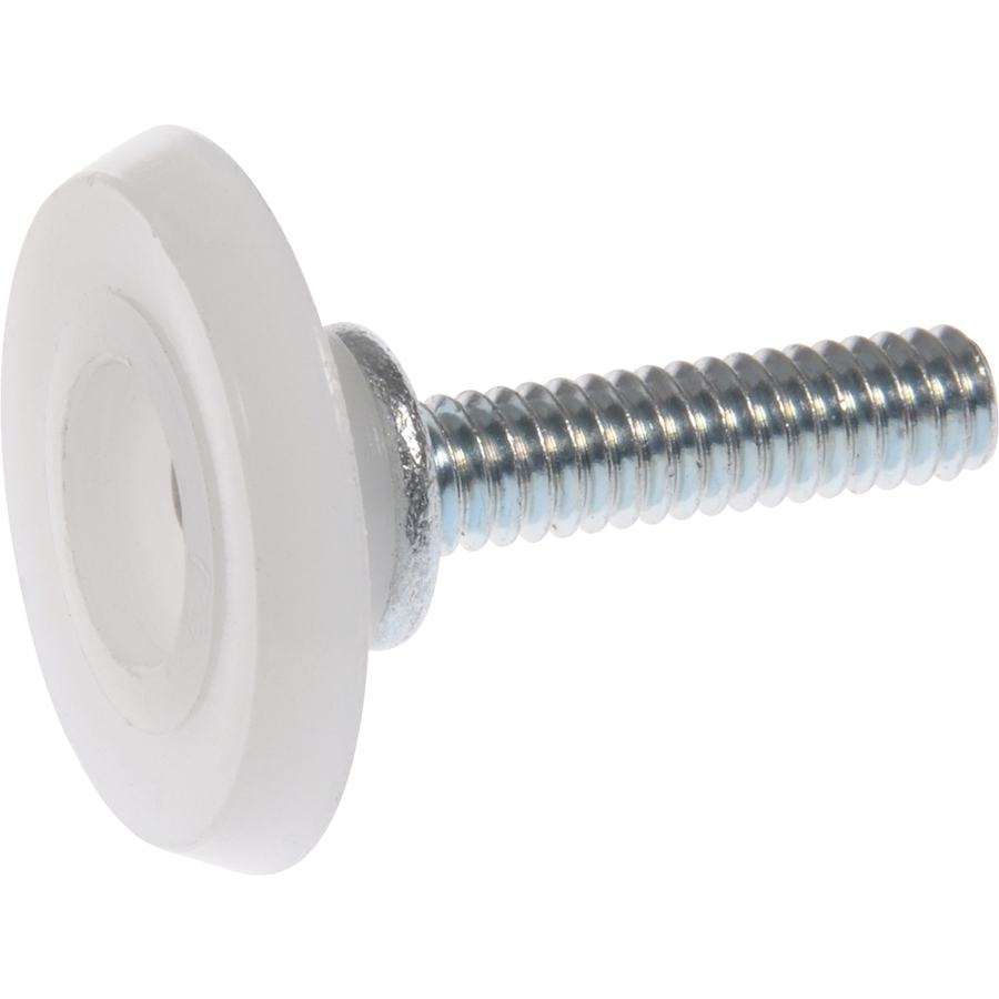

So the plan is to have something in between the spikes and hardwood floor.
I'm thinking a piece of carpet below with some soft drink caps. ::scratch2:
you will need something harder and thicker than a pop bottle cap. with spikes you will be mass loading the entire weight of your speaker onto the surface area of the spikes that you use. You do not need a calculator to figure out that is a lot of mass on a very small point. Rather than spikes which do work well but which are also a pain in the ass (and you won't have one good thing to say about them to your wife the day you scratch her hardwood floor) bet some nylon furniture glides. You will still be loading a lot of mass but onto a little larger area, they make it very easy to position the speaker (the exact opposite of spikes) and they will never leave a mark. It is a very intelligent compromise. Best regards Moray James.

Well I went away from the spikes and have tried a couple different methods. My favorite so far is a rubber foot sold by Parts Express. Very sturdy and the treaded insert will screw right into the exsiting holes with no modification needed. This would allow you to go back to the spikes at a later date if desired.
http://www.parts-express.com/dayton-audio-drfs1-1-3-8-x-1-heavy-duty-rubber-feet-4-pcs--240-712
Yes, rubber feet or square rubber pieces that are usually for furniture sounds better option. :scratch2:
Yes any nylon ones like those allow you to adjust the level of the speaker and still mass load but make positioning a breeze and will never leave a mark. Best regards Moray James.
