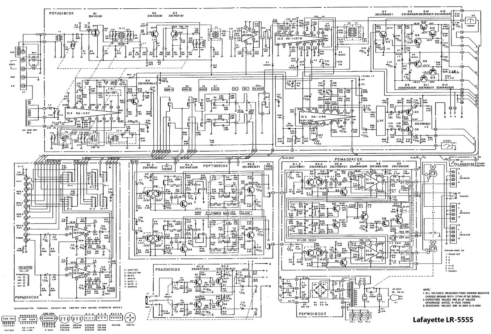

That is one complicated puppy! Click on the image to enlarge.
the voltages are listed so this might be easy to narrow down.

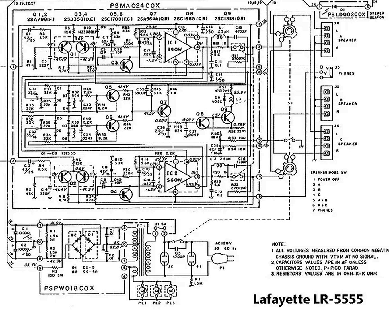

What are the voltages at R19/R20?
This is the output (pin 4) of the power packs. the resistors might be easier to measure if your eyes are suspect.

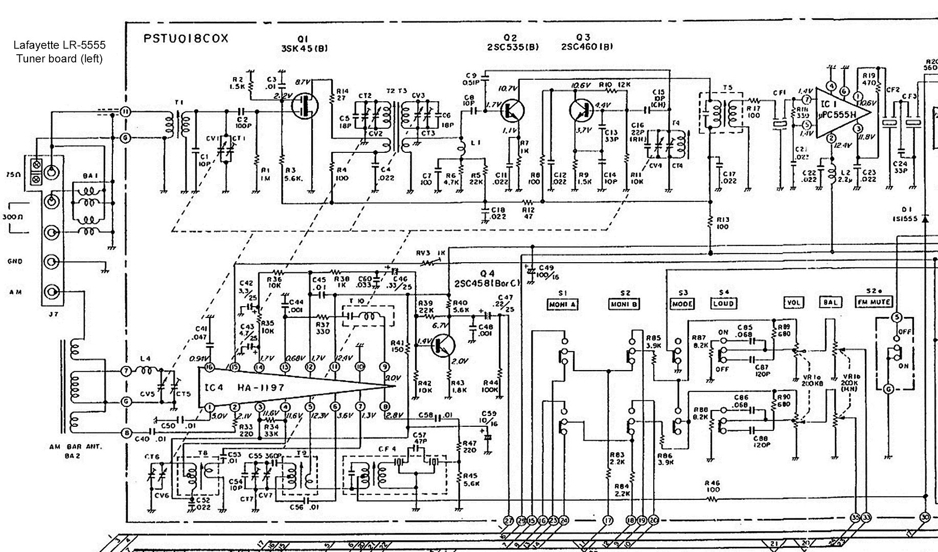

That’s it. I have to use my cellphone camera as a microscope to look at it. But it has everything needed. What happened is everything was working but the 10000 mfd power supply caps were both down to just around 5900 mfd. when I put new caps in the weak transistors at Q7, Q10, and Q11 took a dump. They all were already heat stressed and had the black leg syndrome. It also took out D7. I have new components on the way. This circuit feeds the tuner and the safety circuit. That’s why the relay wasn’t picking up
I checked the power packs and they seem to be within spec. I did find the voltage differential transistors in the safety circuit were open.

I’m sorry. I did answer that. 150-160 MV. I didn’t realize R19 and R20 were connected to pin 4. I measured straight at pin 4. I was looking at the back side of the board. This unit doesn’t come apart easily for service.

Here's a close-up of the power supply and output stage, if that helps.
I just wanted to clarify that the transistors I found bad are on the tuner board. I’m hoping I don’t have anything wrong on the amp board. I’ll need to check. It’s showing good on pins 1 and 4 of the power packs. The amp board is hard to troubleshoot without desoldering the output modules and removing the board from the heatsink. I’ve already done it twice and don’t want to ruin the traces.
I'd verify the voltages at the protection circuit. if pins #4 of each power pack is low and the relay isn't triggering, this should be the first thing to fix (imho).
pins #3, 7 should be +- 0.03v per schematic.

I truly appreciate your support. I just finished taking the amp board apart again and found Q1 and Q2 are both completely open. These will definitely keep the safety relay from latching. I have modern replacements on the way. These are the 2SA798 5 leg transistors. I’m assuming since every component I found open and had black leg disease that the new power supply caps were too much for them. The original caps were very unhealthy and only displayed half their original value.
I think I used 2 matched ksa992 for each a798. Buy 10 and you should be able to find ones close enough. These are on the naughty list.
