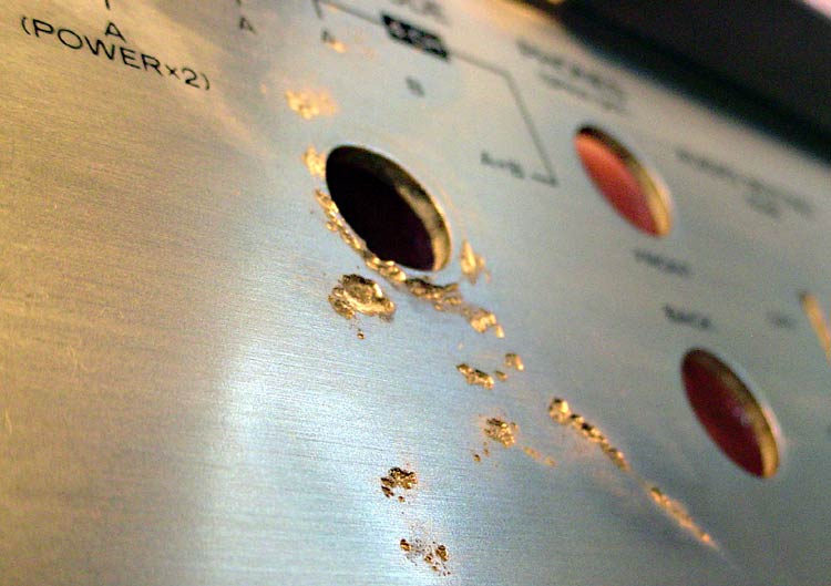

Just to prove the OP ain't the only big dummy out here ... this is what happens when you leave an unprotected faceplate laying flat in storage where mice might decide to camp out ... apparently mouse pee is pretty caustic ...
No amount of polishing was gonna fix that one, but I was lucky enough to find a real nice replacement at a very reasonable price on da bay. We live ... we learn ...
Just to prove the OP ain't the only big dummy out here ... this is what happens when you leave an unprotected faceplate laying flat in storage where mice might decide to camp out ... apparently mouse pee is pretty caustic ....
Urine is basically salt plus ammonia plus water. The corrosive power is a function of how much water is present. Human urine is less concentrated.
I looked it up, and the osmality (amount of dissolved solute) of human urine is 1,430 mOsm/l, a gecko it is 325, a dog is 2,087, a house cat is 3,250, and for a house mouse is 7,000.
So if you really need to get your amp peed on (I don't judge), best stick with geckos. A great slogan for the Gecko Pee Acceptance Society would be: Gecko Pee Destroys Your Amp Less!
