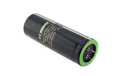

Does one of the valued gentlemen remember the exact size of the PS filter caps of the B-6, especially the large 12000uF cans?
I think this will fit
100mm in height Avionic would know for sure.
Athanasios
Thank you both, highly appreciated! I found a nice Mundorf as a replacement for the 6800 uF capacitor. Same size, 63V, but 10.000 uF. Do you think the higher capacitance is OK for the rectifiers.?
Won't fit:(. Just tried them. The physical size is OK, but the pitch is 10 mm (need 20mm).
Cant you drill out the PCB to make them work? Or add the legs of other parts to extend them to the 20mm holes? I have done this before
