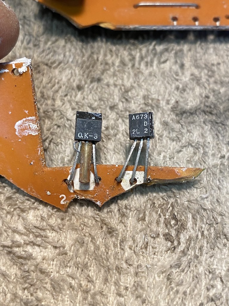

Major Issue.......But I think I can fix it !!!
Not sure if it happened in shipping or if this is why the original owner took it from the repair shop in the mid 80's.....They were hacks !!
Lots of these all over the board.
And the one transistor is holding the broken piece together, so that board is in three pieces !!!
So lots of work ahead here boys and girls !!!!

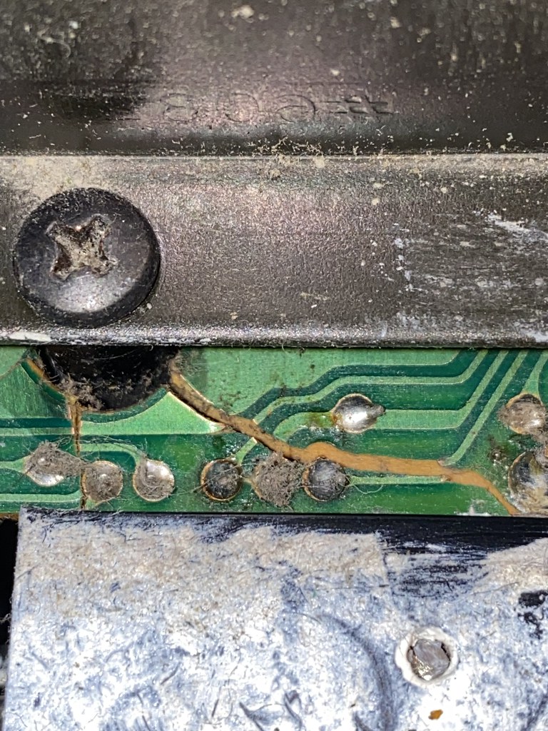

Finding this kind of crappy work all over this amp !!!
Craked solder joints and missing solder joints!!!
Some pics of the boards entireties .
Even cracked solder joints on the two vertical boards that I can see upon inspection, those will have to be removed and gone over with a better view than how they are now.

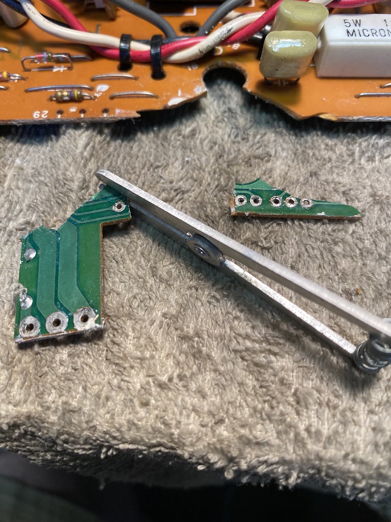

Cleaned up the transistor mounts . The other side I used acetone and it began to remove the
painted surface. this was with soap and water .
Athanasios
PCB support added on top side with CA glue.
That should help keep the PCB from breaking at the broken joints.
