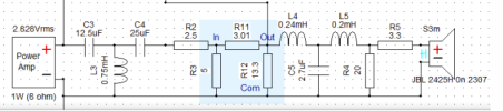

So, while I wait parts for @EarlK 's circuit to arrive from parts express (I am from India, it'll be about 20 days to arrive), I continued to fool around
JBL 4344 MKii HF - Feeble treble. Way too low in quantity
JBL 3155 HF -Nice. Pretty linear with some minor hot spots. Of cource the tweeter doesn't meet MF and there is a void in that 8-10k region
Neverthless, promising, so I started to tweak
This is the 3155 HF:
- Started with C5, changed to 1uF - This calmed down the treble a bit and brought some life to midrange. Still unsatisfactory under 10khz
- Then changed R2 to 10ohm (assuming this is atteunating HF) - Surprise, upper treble dropped a bit further but is extremely evened out. Zero hot spots. It also lifted upper midrange a bit. This is very listenable but heart wants more. HF still doesn't meet MF. Although its very coherent sounding where I can't make out MF --> HF transition.
So I started to read what a parallel RL circuit does. Internet doesn't tell a lot, someone said it's a notch filter
What I am trying to achieve is a lesser steep slope for HF atteunation. Question for kind souls at AK:
1) What component decides the HF slope in this circuit?
2) What happens when L4 and R2 go up or down in values?
I know, I am throwing at wall until something sticks and at this point I should have some kind of measurement gear. But as someone with only soldering skills I can rely only on ears.

You need to start playing with a crossover simulator ( which will give you visual feedback to your proposed component changes ).
Download the XSim ( .exe ) application.
- Best to keep your project files in a separate folder.
Here's a modified 3107 network ( with added horn-driver attenuation && a horn-driver LowPass for an @ 10K crossover point ).
I've included the XSim file ( zipped .dxo file ) for you to play with ( it uses my 2425h measurements and Widgets 077//2405H measurements ) .
- Right-Click on a part to change its values.
Removing R1 gives the bump centered at 10K, due to changing the "Q" of the LC parts interacting.
- Don't run with that or the circuit impedance at 10K will drop below 3 ohms ( which can be an amp wrecker for many amps ).
Note: when XSim opens a file, it opens the frequency response window to 1/24db smoothing ( which is pretty jarring to look at > and un-necessarily HiRez ).
Change it to 1/6 db smoothing ( as this is accepted as being around the amount of detail that the human ear can reliably discern ).
@EarlK Can Lpads can be replaced with fixed values as suggested in your circuit ? Because I'd like to replicate as is, fixed values will do that, correct ?
Yes
PS; ( IME ) its best to start-off using the variable Lpads + then once relative levels are established ( & enjoyed over a period of time ) > then replace with fixed resistors
@EarlK ,I built the circuit and find the midrange volume too low. I used fixed values instead of lpad. Think of using lpad to play with adjustment
Question, what all resistors can be eliminated if I used Lpad instead? 2.5/5/3.01/13.3 or 5/3.01/13.3 or 3.01/13.3 ?
