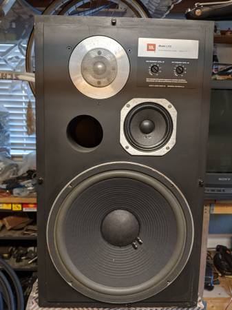

JBL L112s w/ black woofers
It looks like a 128H-1 cone to me. The 128H-1 is acoustically identical to the white 128H, but with a black cone. It should not cause any issues.
The JBL 4412A Studio Monitor, that used the black 128H-1, was still sold up until 15 years ago or so. That caused there to be continued supply of 128H-1 woofers and official 128H-1 recone kits. Many white 128H woofers were reconed with 128H-1 kits or simply replaced with 128H-1 woofers, because they were available.
I noticed upon in-person inspection that the surrounds were glued to the front of the driver — oof. Hack refoaming job. I'd already gathered from my AK research that it would likely take a full recone job on the woofers to set the job right. Was looking forward to picking them up, but passed.
Thanks again for the guidance
I’ve got a pair of L100’s with black woofers as well, not sure if they are original equipment or not. I don’t “think” that the L100’s ever came with a black woofer, but have never investigated it...it’d be interesting to know.
Sure looks glued to the cone back in the photo.
No, JBL never sold the L100 Century / L100A Century L100A Century with black cones.
Are you sure that they were glued to the front?
Here is an example of a 128H-1 with the foam glued correctly to the rear:
Here is an example of a 128H-1 with the foam on the front (bad):
Your pic for comparison:
Looks a lot more like the first example than the second. Usually it's pretty obvious when the foam is glued to the front.
