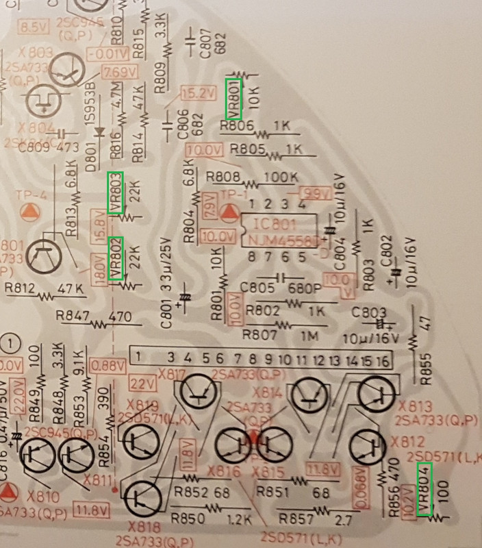

Could anyone hazard a guess as to what VR801 is meant to adjust?
VR804 is for the 'balance adjustment'
VR803 & VR802 are for speeds 45 and 33 respectively.
The manual doesn't mention VR801 except "Set the semi-fixed resistors VR801-804 to the mid position" when performing the power supply voltage check, prior to adjusting speed and balance.

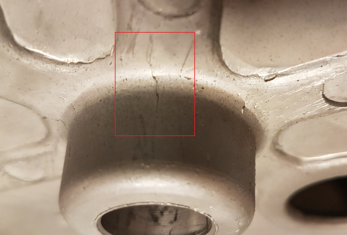

On closer inspection, there are several stress marks / cracks on the underside of the platter near the part that meets the spindle. Is this damage, or something left over from manufacturing?

Regarding the crack, most likely from the casting. Probably cooled too fast.
