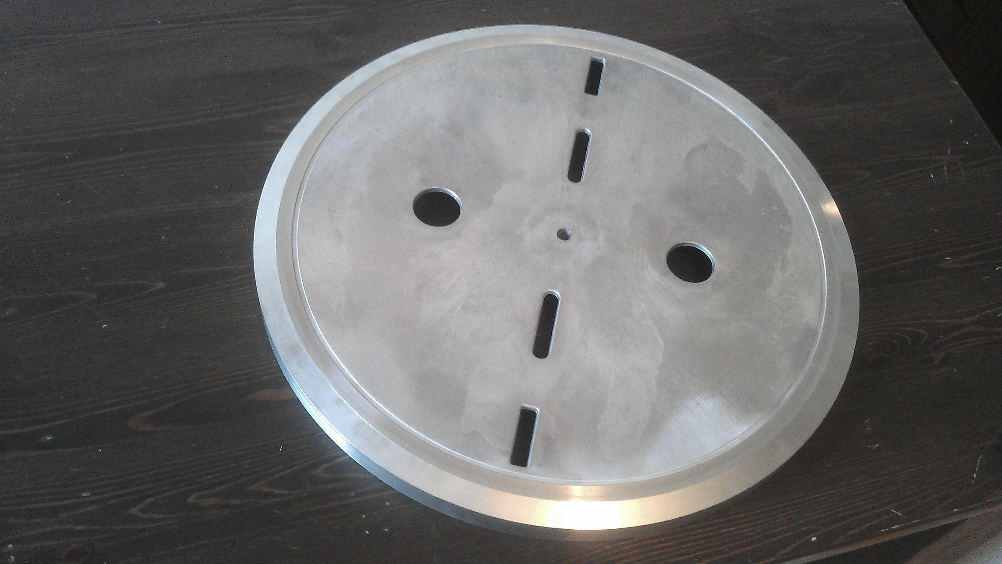

Does anyone have the last year model what is it called? Y44F. I want to see the platter! The Y7 platter is a work of art.
I tried lifting the platter gently and it moves upward a little bit but stops, looks like I'd need to disasemble some stuff to take it out and I don't want to dissasemble my table. sorry :(
lift up on the platter, and while lifting give the spindle a hard rap with something like a screwdriver handle. It should pop right off.
BillWojo
It’s just stuck due to being on there so long. I’ve had it happen to a few tables including a JVC.
Use both thumbs and push down on the center post why pulling up through the holes in platter with your fingers.
It might take a few tries and some effort. I would gently rock it a little as you lift. Try several times by pressing hard but the thumbs on the center post but not crazy enough to damage it. It may take a few tries.
One of mine took about five minutes of attempting don’t overdo it and the gentle wrap with a rubber mallet or a plastic mallet might be needed.

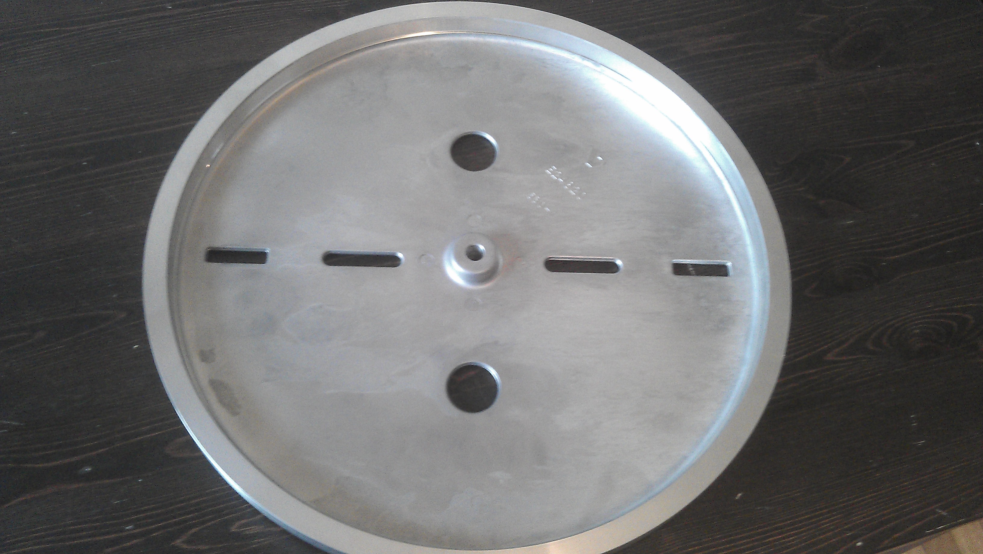

I was able to lift the platter without too much force, thankfully. Pressed a little bit on the spindle with my thumbs and it came of. Whew! I'm relieved. I really didn't want to have to put too much pressure on the spindle. Thankfully, just a tiny little bit was necessary.
The underside is pretty spartan, there are no fancy designs, no ''spokes''. My guess is that : for the record-size auto-detect light sensor system to work, there needs to be no big ''spokes'', as those would obstruct the light beam.
The platter weighs 1.5 kg*, on this table from 1986. which is lighter than QL-Y models with higher numbers but... oh well. the table still has great specs and sounds superb.
And I like the size, and height, and look of the platter regardless (with it's big cylinder-with-tapered-edge look)
*I weighted it with an electronic stand-on balance, so not the most accurate it could be. But it consistently gave me 1.5 kg
And that begs the question as to what a platter from a QL-A7 weighs. I don't have a small scale and VE doesn't have that spec neither does the manual.
