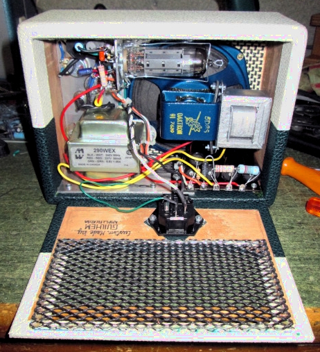

No @valvenator : it was not an original feature. The two rear panels closed all the back of the amp (it was Solid State). I cut one of the panels to vent the back and the tubes, and added that metal grill mesh (in French : métal déployé).
This product is commonly available in DIY stores here in France, in different sizes, mesh and thickness, in Aluminium or Steel. Here, it's a black Steel, thickness 2.5mm.
I used the same grid material on these DIY amps below - simply glued or more often glued plus screwed to the back panel :

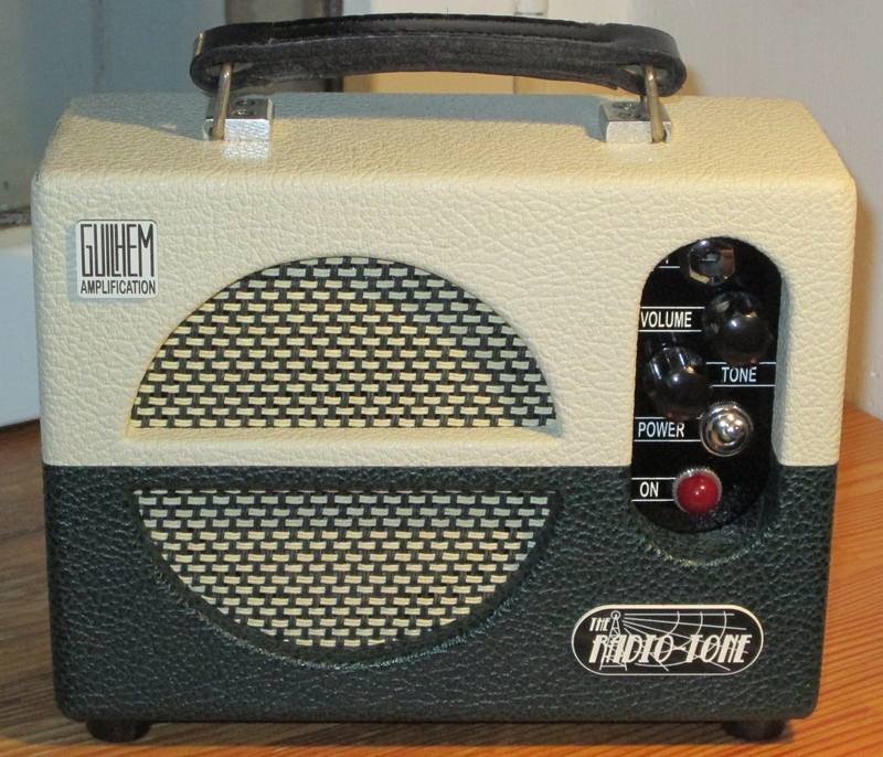

From small...
This one is just too adorable for words!
Thanls @valvenator !

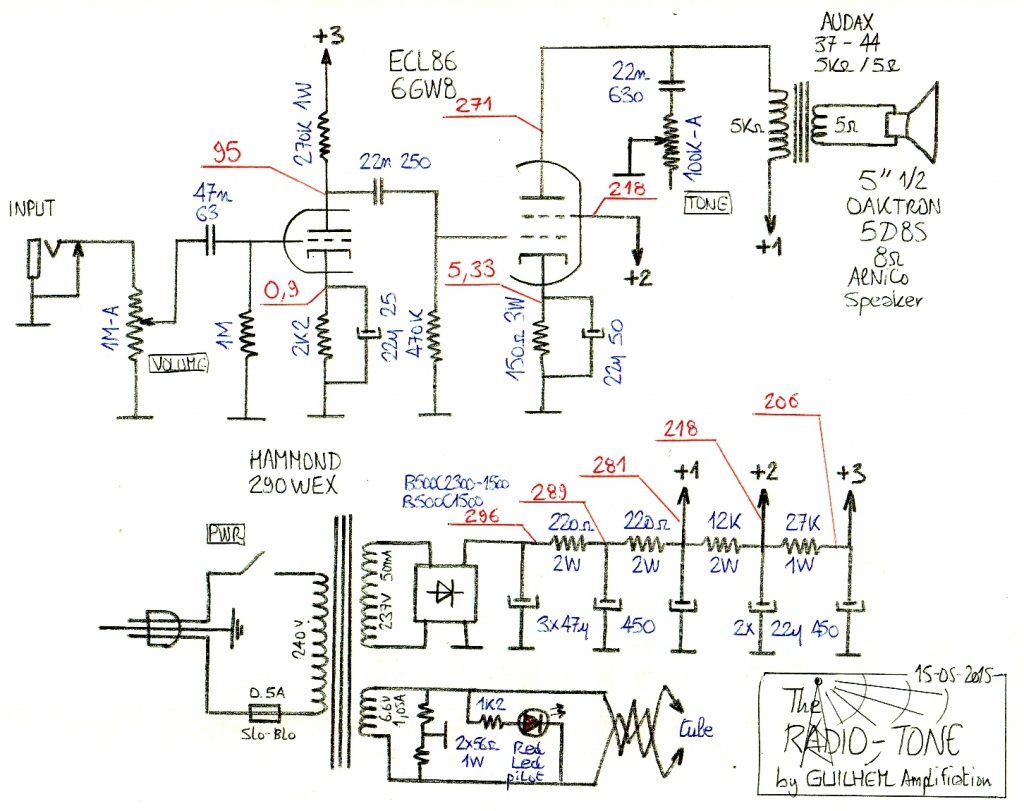

Despite its very small size, the Radio-Tone is nonetheless a fully playable and standalone unit... Even if by now, it is used as a card displayer in a local music shop, for my little part-time amp repair business...
For those who are interested, here's the complete schematic - the power output is circa 2WRMS at onset of clipping :

Are you telling me there's only one tube doing all the dirty work? Brother, that's amazing!
Yes, that's it : only one ECL86 / 6GW8. Here's a small sample of that amp, played with a Squier Std Strat, with a touch of external reverb (EHX Cathedral) :
My design is inspired from the MagnaTone model 411 amplifier, with some modifications, notably the removal of the tremolo section :
