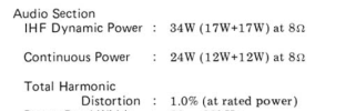

just brought this home today. took about an hour to repair. had 2 bad outputs so i replaced all 4. that's all it took. nice sounding 12wpc.
there's some c458 i need to get rid of and the obligatory recap of course. and some bulbs.
i like it.
finding other stuff wrong with this thing.
i like it.

i just can not get much more than about 8.5wpc then the signal clips, power supply sags and distortion climbs.
i've got a few more things to look at but i'm not very confident of getting another 3wpc. lol.
i know it's botl but i just want it to be right.

it's post 1974(as far as i can find but no definite year of sale) so i wouldn't expect too much exaggeration.
Well the heatsink looks awfully small.. The tranny looks a lot more promising, but then again it has to run a lot of bulbs right? I'm absolutely loving that display though! What is the capacitance of the main buffer caps?
14 bulbs are on their own separate ac winding.
filter caps are 1000uf each.

Filter caps OK? Only 1000 uF . . .
brand new as are the bridge rect. diodes. outputs replaced with ksd526. all silicon replaced besides 6 diodes that are getting shotgunned next session.

Maybe try it with an external preamp to rule out/confirm the problem is in the amp . . . Interesting to find a pre-out/main-in on such a low end receiver.
same either way.
i really did not mean this to turn into troubleshooting, i just wanted to know if this unit really pushes 12wpc or if i was chasing my own tail.

Anyway, considering the small outputs, tiny heatsink, ambiguous tranny output and 1000uf caps.. 12 WPC might be ambitious. But I think he should still make it, right? I would definitely put in 2200uf replacements, assuming the diodes you put in got plenty capacity to deal with that.
I understand now you can also use it as a tuner-pre amp, with something else doing the heavy lifting. That might not be a bad idea. Perhaps they figured you could use it as stand alone, untill you saved up to add a Poweramp and bigger speakers?

the thought had crossed my mind to go with 2200uf caps but if this power supply can't supply the power to get 12wpc, once the larger caps are depleted the power supply will just have to work that much harder to run the amp and try to recharge the caps so i do not think that is viable.
maybe i will try that as an experiment to see how much, if any power is lost.:idea:
i have had a couple units from this era that came up just short of rated power. i can attribute most of that to my measuring setup but i felt that 30% less was/is extreme.
the only history i have of this is that i bought it from a guy that bought it from a tinkerer's estate.
if there is a fault, it should not be this hard to find as there are only so many components common to both amp channels.:dunno:
