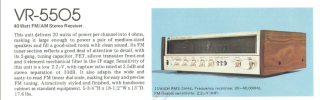

from a 1975 jvc catalog:
note it says : 20watts of power into 4 ohm. does not say per channel. the pic desc. says 11w/ch rms @1khz but does not list ohm.
i am making the call that my unit is fine.
prior to 75 there was a unit called the vr5505l that had a longwave tuner as well.

Maybe the 5 is actually 1975 and they changed it later. My oldest JVC is from 1982 and that date system ELzekio came up with works for everything I have. You can verify on CD players because they have the date and month on the label with the serial number. That's a nice looking basic receiver. It probably won't fill a stadium with sound but would probably play loud enough to fill a room with efficient speakers.
yeah, maybe june 1975.
10 watts at 4 ohms would be about 5 maybe 6 watts RMS at 8 ohms, looks like some math is off the mark. Honestly I'd say its capable of 10 watts RMS into 8 ohms both channels driven with good caps on a 1 KHz sinewave.

This comes from the 1975 Stereo Review Buyer's Guide that was probably released late 1974 or early 1975.
Good to confirm your original power output measurement was spot on . . .8.5 WPC vs spec of 8
yes it is and i'm down around .13%thd vs. 1%.
just finished recapping the unit and did a slight tweak to the tuner.
bulbs will be here this week.
i spent more time researching than repairing. i might have spent more time researching than i did on the actual unit itself.
