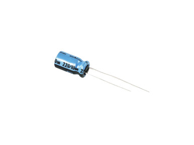

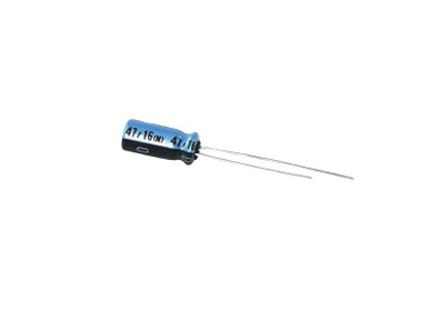

C103, C104 47uF 16V,
C107, C108 220uF 6.3V
All are the same size 10mm wide x 16 tall, spacing 4mm

I went down the Black Gate rabbit hole and it hurt my brain. Near as I can tell the original BG that are in the M-45 were discontinued many moon's ago. All the series of caps are confusing as hell. This is what I came up with on Mouser. These are the UES "Muse" series. Please advise if incorrect.
UES1C470MPM Nichicon | Mouser These are currently out of stock. Expected 3/31/2025! WTF
UES0J221MPM Nichicon | Mouser
