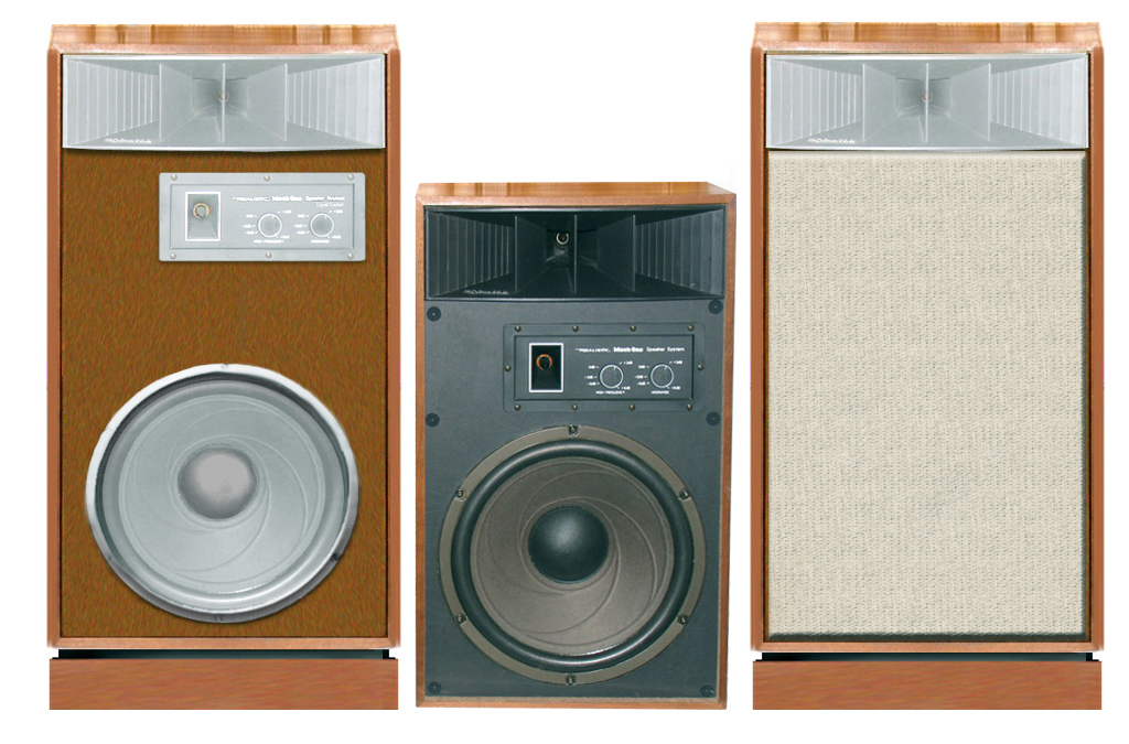

Tier 2 & 3
O.K. the second speaker is done and I have listened to Bill Evans for jazz piano,Buddy Guy for blues guitar and Paul Simon's Graceland for some rocking tunes and I gotta say the Mach 1's are sounding real good.I don't have a ton of knowledge to know how or what to compare these to but compared to how they did sound these are WFB...by far.
What is the 2nd tier about? Tweeter tweek? and then a 3rd tier too?
Of course I don't have the crossover quite right though.I have a 22uF and a 10uF in there only because I don't have a 14uF and an 8.2 on hand.I'll include them in the next order.And hey...I saved a ton on the inductor too by unspooling 52 turns,right?
videolady201 many thanks to you for your effort on these old boys.
The 2nd level will be full 3rd order crossovers and upgrades to the Woofer & Tweeter. The 3rd level will be, well... See the attached image. More details to come later!:thmbsp:
