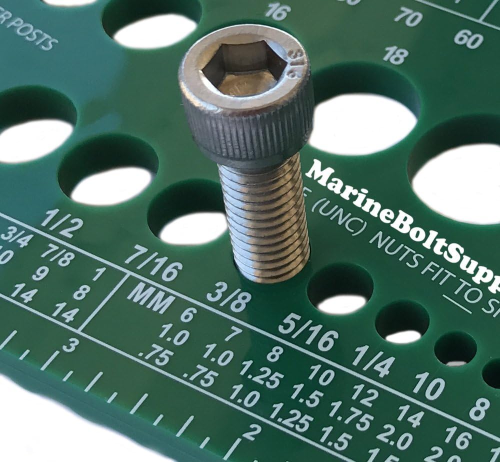

May give this one a go, it has the diameter and pitch for both:
https://www.amazon.com/dp/B07K7W3NQQ/ref=sspa_dk_detail_0?psc=1&pd_rd_i=B07K7W3NQQ&pd_rd_w=J5Exi
EDIT: Changed my mind, this one does coarse and fine threads, the one above doesn't.
https://www.amazon.com/dp/B06X15YV6X/ref=twister_B01N49J16B?_encoding=UTF8&psc=1
Well let's see if we target a "well known" screw say on a 1200, I'll let you know what I read and you check as well. Next thing will be finding a good source for the screws.
Sounds good. The screws that hold the phono, tone, and other daughter board in, are really tight pitch and a thinner diameter, there's only three of these screws in mine, almost 100% certain they're stock. Curious to see if you have those too.
The A7 Power Supply board, and A8 Relay board are mounted like the above, but the Phono, X10, and Tone boards are held in to the Interconnect board with these plastic blocks:
It's these three blocks that have a different screw on mine. The screw that holds in the A2 Phono board, must be that screw, or it will put too much pressure on the IC board, and break the Balance pot (in my case).
