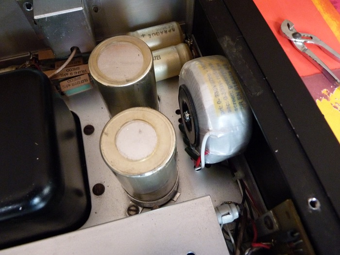

I am installing another transformer in a recapped 18. The original transformer was ruined by a so called rewinder.
I can send you a folder with instruction for how to install a separate scope transformer:
You can send me your email in MP.
I installed the donor power transformer and AKer RV59's stand alone scope transformer and all went well . A big thank you to RV59 for all his help and a real nice job on his design and directions . My 18 is playing, both channels , scope is working but I have no bias on the left, I get no reading across R28 (0.47ohm5W) or R35. I tested the trim pot and its tracking ok, I lifted the emitter resistors and I got 0.7 ohm &0.9 ohm . . I'm using MJ21193/94 outputs transistors . I tried matching voltages with the other channel (I have 61mV on the right across both emitter resistors ) I didn't find any other discrepancies . I'm cleaning the trim pots again . Any suggestions ?

I might have found the problem. The Emitter of Q1 is soldered to the case of the trim pot for the wiper connection (by design) . I think it needs a good hot solder joint , I think I got one this time. The channel has previous repair work and there was a big glob of solder on the trim pot . I've been testing it and so far its working with a little tweaking of the trim pot each time .
I'm still chasing this amp Bias adjustment. I swapped the trim pot with one from my donor unit and have the same results . The bias will be good and stable then drop off to 0mV then come back and fluctuate up and down, sometimes its goes to zero sometimes to 80mV it doesn't seem to effect the output of the channel (headphones) ??????
I found a leaky Q7 and diode CR17 , replaced both and the channel is now good. I also replaced CR18(3x IN4148) on the other channel and it made the bias stable . I think I'm good to go, and put this 18 back together.
