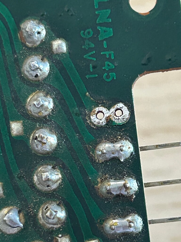

I digitized PE01 from original board that i have. And then Made layout of elements from the manual.
I am going to use it as reference to reproduce correct schematic and new PCB.
Schematic that we all have in our manual is wrong

Meanwhile, i am routing PE01. There is nothing to show yet, since original schematic full of error and simply doesn't match the PCB in the amp. So i made trace layout and component layout and reconstructing schematic from original PCB instead. As soon as I have something to show, i'll post it here.
Traces obtained by taking picture of the PCBs bottom and cleaning it later with photo editor. Width of the board is 238mm.

Elements layer obtained from schematic. Cleaned it up a little. As you may notice, it is not in match with traces, but gives good enough understanding of components placement.
