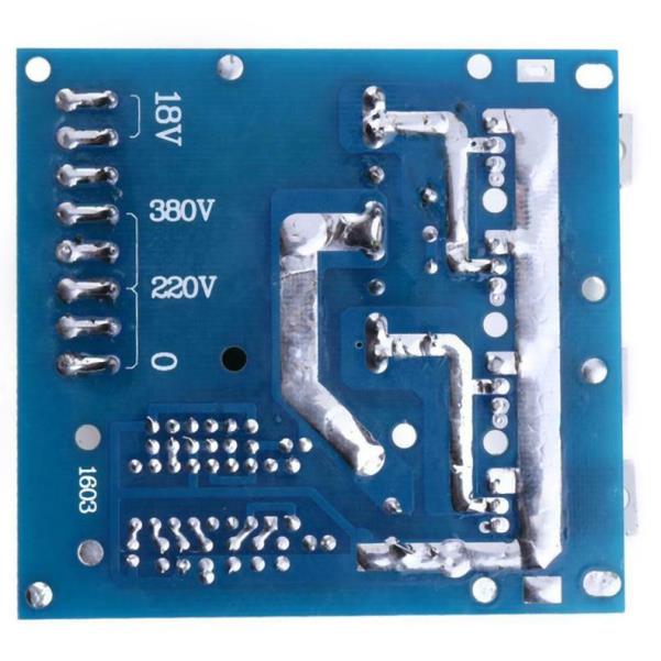

One better method of constraining FET drain parasitic noise current loop is to use an insulator with an internal foil - the foil is returned to a switching stage rail, and acts as a screen to noise currents flowing over to the actual heatsink (which in post #101 would be the aluminium sub-chassis) - there used to be commercial insulator products of that design, although the same can be done using a DIY construction, and keeping the link from the screen and the pcb node as short and direct as possible.
The image below is the 12V 500W inverter pcb - it looks like some of the secondary side former pins are not used, which would certainly make it easier to use as spare terminals for making up whatever rectifier and filter configuration suited the application.
Yes, the other pins/holes are not used (No actual transformer tap connected to every other pin.) So Yeah, mounting diodes there is a good idea.
In addition, I'd like to point out that since the 18V connections are a separate winding, they can be used to generate a (-) voltage for bias just as one would use a separate winding of a 60Hz transformer, just make sure to use fast diodes, and high frequency filtering because this is one place you'll really hear any noise, esp. on a SE amp.

This picture shows (from bottom up) a 12VDC 20A SMPS driving a 380VDC power supply based on the previously mentioned "500W" inverter board. I am using (3) 60W light bulbs in series as a load bank.
I'm still working on this. As of right now, it is no where near being acceptable for actually powering an amplifier. It's unstable in both output and thermally. It will produce almost 380V @ 700ma, but is sings (audibly -- a high pitched whine), and it is completely unstable at certain voltage settings. Note however, that 700ma is almost twice what I need for the planned amplifier, so I may still be able to get this running "well enough". I don't know yet.
As you can see, I have added a bridge rectifier made from 4 high speed switching diodes, A filter cap, and a simple feedback circuit.
The 12VDC power supply is probably running at about 10-12A, (rated @20A) so it barely gets warm at all, which is impressive for such a compact power supply.
I'm not sure why (3) 60W bulbs add up to over 260W, but I need to get some smaller bulbs, or another suitable load.

I have received 2 of the 300V/250W PS's mentioned in the previous post.
I wouldn't say I've thoroughly tested them, but here is an initial review:
As shown in the previous post, the listing mentioned 110/220 VAC input, but as I suspected they are "wide" input range, not just a manual or automatic switch.
Note the adjustment to the right of the terminal strip. This pot adjusts all 3 outputs.
(Note: The watermarks are not intended to advertise my site. They are intended to prevent the picture from being used in ads/listings.)
Mine showed 300.1 when I first powered it up, but that made the heater voltages a little on the high side -- like 6.6, and nearly 13VDC (no load). With the 6.3 set to -- 6.3, the 12V was just over 12.6, and the 300V was just under 280V. All this is fine for the intended project. With these adjustable SMPS's, I set the heaters just a couple tenths low for good heater life while still having good cathode conditions. In this case, that means I guess I'll take what I get for B+.
Interestingly, there seem to be 3 opto-isolators on the board implying 1) true isolation, and 2) individual feed back. So I am not really sure why there is one pot for all 3 voltages.
So how about noise? Well, Arm your "I told you so's"... You may (or may not) need them...
The first capture is with no load (We are looking at the 300V output set for 280VDC). The second is with a small load (only about 20% of rated). I haven't taken more captures, and I'm having problems finding a really appropriate load, but they don't seem to get much worse as the load increases further.
Before you unload on me about 30V P-P ripple on a 280V PS, keep in mind that it's not like 30V P-P of 60Hz PS ripple from a linear power supply. The actual ripple looks pretty good if you overlook the spikes. There isn't much energy in those spikes, so it should be pretty easy to further filter. It's actually a much better story than the P-P value would suggest.
On that note, I don't see any inductors on any of the outputs. I think at SMPS frequencies, inductors are really important for someone (me or the Chinese) trying to push these things for audio use. I must assume that they intend that the inductors and further filtering are a downstream part of the amplifier.
I would also like to note that there is filtering on the input, and my amp will use an IEC connector with an additional filter in it. I'm not really concerned that these things will put stuff back on the AC lines any more than any other modern device (like a TV or PC) would.
There is also no audible whine at all coming from the unit, even with the biggest load I've tried so far.
