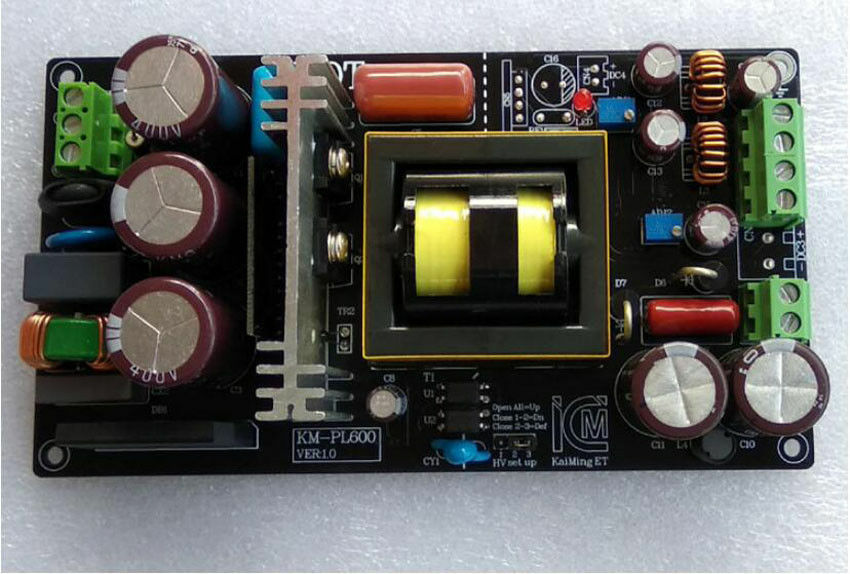

As mentioned, these are the inverter supplies. They are essentially exactly what is needed for a simple, inexpensive tube power supply except for the secondary components (Rectifier, filter, and optionally feedback.)
Note that the one in the center, and the one at the top are almost identical circuitry, just a different form factor.
As you can see, I quickly made up a few rectifiers with the high speed glass diodes I bought.
What they are doing here is basically running a SG3525 PWM chip open loop. There's no regulation or voltage adjustment.
There are different taps on the secondary of the transformer, although not all pins are connected. V0 -to- V5 on the smaller units is 220VAC. There is nothing connected to the hole marked V1.
Even using the last tap on the smaller supply, I didn't get as much voltage as I would have liked to, so I tried the shown voltage doubler. On the 2nd (real) tap, as shown I get about 380V no-load, and about 350V with load. Connecting to a higher tap would result in "unpleasant things" happening to the shown 100µF/400V capacitors.
In working with these things last night, nothing got even slightly warm except the load resistor I was using. Attempting to continue to use the (was blue, now brown) resistor I was using will very likely result in a fire. While I can't leave the power supply running very long due to lack of a suitable load, at one point, it was supplying 170ma at ~350V, without even appearing to struggle at all.

I successfully modified the smaller inverter so that I could adjust the duty cycle, and thus the voltage. All it took was a 10K pot, and a 100K feedback resistor from pin 9 of the SG3525.
The problem I'm having now is a tremendous voltage drop from no-load to full load.
For the voltage doubler connected as show, and set for 320V under full load, it's 380V no-load. I think most of the voltage drop is happening in the small windings of the transformer.
I think I'm going to try actual feedback voltage regulation. At least I'll learn a little more about SMPS's.

I've basically made a regulated voltage doubler supply out of one of the smaller inverter modules. Output is about 324V at no-load, and around 314V (lowest setting) once the tubes start conducting.
It works, and it will run for hours, but it gets noisy after about the first 5 - 15 minutes. For one song, it's someplace between dead quiet, and acceptable for an experimental amp. After about 15 minutes, it slowly develops something similar to a 60hz hum, but ... Different. As an instructor used to say, it's "Rich in Frequencies" ("Rrrreech en Fleeckwencies" as he said it). I mention the noisy environment because I have the even "hot" noise down to the point where between the fish tank and the AC, it's "almost acceptable". It's not low enough, however to call success, or for normal listening.
I've also made a larger heatsink and used insulators to attach the MOSFETs. It gets quite hot, and I think the MOSFETs may be causing noise/instability when they get hot.

I made a new, and much larger heatsink/mounting bracket. It's still trying, but it's having difficulty getting this heatsink as hot. It's been running for 20minutes, and the hum is not audible 3 ft away with the Airconditioner running. Definitely not near as bad as when I captured the 3rd wave form in my previous post.
The heatsink/bracket is not attached to the chassis at this time. It's sill sitting on top of the CD jewel case.
I get that if it is really 60Hz, it has to be (most likely) from the PS that is connected to the AC Line, but it is not a stable frequency. Not on the scopemeter, or audibly. The captures above can't show that. Also, There definitely seems to be correlation between the temperature of the Plate Supply MOSFETS and the hum.
I just made is so that I can run the plate supply from my bench power supply, and the rest is running from the internal 12VDC supply...
Edit: (Returns connected, of course.)
Now I have to listen to music for an hour again. Testing tube amps is tough work.
Over an hour now running with the plate supply powered from my bench power supply, and the rest running from the internal 12VDC supply.
No increase in hum/buzz from just after startup. @gadget73 was right. The 60Hz (low frequency stuff) has to be coming from the main supply.

I continue to research SMSP's with appropriate output voltage for a full power PP Tube amp --- And --- There actually are some:
(Ebay image link -- no vendor shown or mentioned -- link will expire at some point)
This unit runs from 200-240 VAC input, and provides DC200V-520V as the main (Plate) output as well as several DC voltages for heaters, and a (-) DC for bias.
It is fully isolated, even to the point of using optical isolators for the feedback.
The B+ is customizable when you order, but not adjustable. I need to contact the vendor, and see if they have or can make a version for US line voltages.
It's rated at 300W continuous, which is nearly twice my power budget for even a PP 7591 amp.
There is another similar unit rated at 150W (total), and with a 95-265 VAC input. It's HV (B+) is rated for 300ma (max) which is not enough for a "big bottle" PP amp, but it may be adequate for a smaller PP amp, or a SE 6BQ5 setup. It also has a 6.3V output for heaters.
There's an even smaller version rated at 60W, which is probably only appropriate for preamps. It has the same 95-265 VAC input, and is really small. These last 2 are also isolated.
