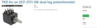

I recall a post a few years ago about a high-end trim pot, but don't recall the manufacturer. Anyone have more information?

I don't know if there is a company making audiophile grade specific trimmer pots, but there is an ISO 9000 company in Riverside CA called Bourns, Inc whose core competency is making world-wide respected trimmer pots under the brand name Trimpot(tm). You'd be hard pressed to find better. Admission: I am a Bourns retiree. Their products undergo rigorous in-house load-life and environmental testing, so fly by night they are not. I know this because I have tortured many a trimmer to their demise, reporting my findings as I went.
I don’t think that would be considered a trim pot, a set it and forget it amp adjustment pot. What you show is probably intended to be a volume pot or other regularly used audio adjustment pot
Used to be that Allen Bradley 'J' milspec were considered the best of the standard size pots.
Bournes Cermet trimpots are good modern types if not the best.

However, the demise of their pots is not such a sad event. Both RF11 and RF15 have image creep at low levels (fact - test yours if you have some). They also become noisy and need lubricating if used anywhere warm. I don't think they were ever as good as the TKD CP2500, and not really as good as high-end ALPS such as RK40 and 50. In terms of electrical performance, P+G pots were barely better than ALPS RK27, but at many times the price did not represent great value. P+G was a great company and it's sad that most of the potentiometer division's lines have been culled, but I wouldn't lose too much sleep over the pots.
